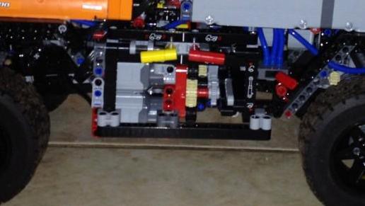

I don't know if this has been done before but how about a lowrider Unimog?
I got the idea from flipping the portal axles over, the rest of the build is almost stock. Here it is at ride height:
I had to move up the cab and bed two units to make room for the cylinders. A cylinder on each end acts on angle arms to move the short shocks into position.
The pump raises the truck, gravity brings it back down!
The rear end is built the same way. Here is front down "California Rake":
Rear down "Taildragger":
And almost laying frame, "Pancaked":
You can slide a piece of paper under it when it is this low but it won't roll as the wheels are resting on the fenders,

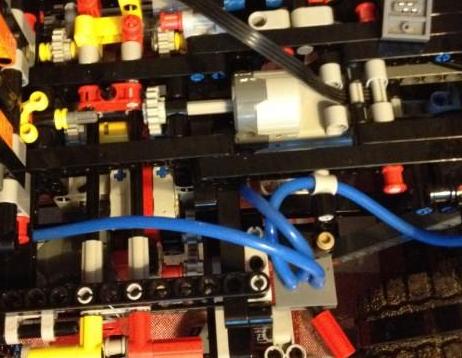

Sure thing! Hope these work as I tore it all apart last night...
Here's the flipped portal axle and short shcok in the rear:
Here's a top view with the ram extended.
And here's the top view in the lowered position:
And lastly,.here's the front end up close:
