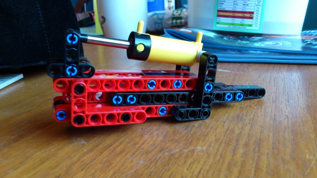

I've made a prototype extending boom, am waiting on parts from bricklink to finish it. I started before seeing that one of the 8110 prototypes had an extending boom. mines made pretty differently to that one, its not a very elegant design, it works tho, bit heavy for my liking really. I'll be posting photos and asking for advice to improve it when the new cylinder turns up to test it properly.

Well I recieved my parts from brick link today so have built up my extending boom for the crane. I'm not entirely happy with it, I think the design could be better, it robs the crane of a little too much capacity I feel. Hopefully some people can come up with some suggestions to lighten it and improve things somewhat.
I'll let the photos do the talking from here...
http://i49.photobucket.com/albums/f261/theozboy/Unimog%20Extending%20Crane/DSC_1137.jpg
It improves the distance away from the truck you can pick things up, I would have liked 2 rams back to back but I feel the weight would rob the crane of pretty much its whole capacity without major modification to the rest of the crane. I like the elegance it too much to beef it up...
Come on TLC when are you going to produce longer rams?
Retracted
Extended
Retracted
I like ur idea but it's very bulky,also it doesn't extend much and this is why we need longer cylinders.
