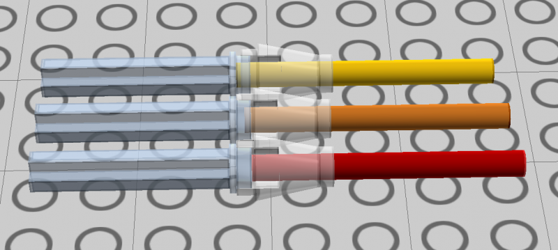

Superkalle Posted January 23, 2015 Author Posted January 23, 2015 On 1/23/2015 at 9:15 AM, mzoli said: 30374 connects with 6587, 4589 connects with 6587, 30374 connects with 4589. But you can't connect these 3 parts together. (LDD removes one of them reopening the file) Yeah, this is a well known bug. There is a workaround though, not perfect, but still. Looking at the attached image - Yellow bar will work - Orange bar will be removed - Red bar will work For the yellow bar, the trick is to place the bar first, and then the 1x1 cone Quote
mzoli Posted January 23, 2015 Posted January 23, 2015 Thanks Superkalle, I experienced the same. Yellow and red work but the 3 parts are not connected together, just 2 of the 3. Next time I wil try to search the forum before I post a known bug. Quote
Superkalle Posted January 23, 2015 Author Posted January 23, 2015 On 1/23/2015 at 3:27 PM, mzoli said: Next time I wil try to search the forum before I post a known bug. No worries. Quote

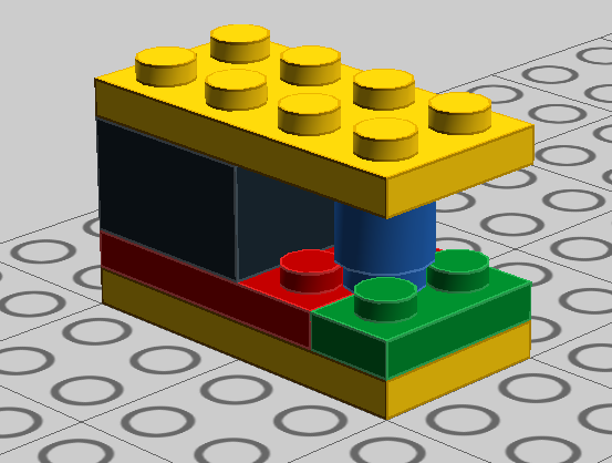

Stephan Posted February 5, 2015 Posted February 5, 2015 (edited) Part 3960 ROUND PLATE Ø32X6.4 does not fit all the way in 86652 RIM Ø 43,2 X 18. As seen on THIS image. This is as far as it goes: It's is used on page 96 of the 75060 Slave I set. Part 32187 MIDDLE RING has a too big collision volume. Due to that two of the same parts do not fit together on the narrow end: Part 71155 NET 10X10 is modelled as a filled square. Therefore it is not possible to put the two 30374 LIGHT SWORD - BLADEs through the net (as seen on page 41 of set 7625 River Chase): Edited February 6, 2015 by Stephan Quote

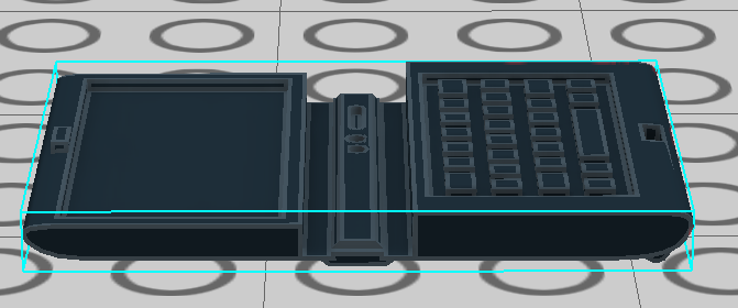

Happy SDE Posted February 12, 2015 Posted February 12, 2015 (edited) I failed to bend a laptop (62698). It is always opened like here: Edited February 12, 2015 by Happy SDE Quote
suenkachun Posted February 12, 2015 Posted February 12, 2015 (edited) On 2/12/2015 at 12:29 AM, Happy SDE said: I failed to bend a laptop (62698). It is always opened like here: If you refer to my post #733 earlier above, I have mentioned this issue together with a few related issues. Below is a recap.Certain Bricks in LDD cannot be closed properly. The Book (Part 33009) used to be opened but in the latest version it was closed, occupying less space and looking better. However, both the Bag (Part 6203) and the Suitcase With Film Hinge (Part 33007) has their covers unclosed. Both of these parts should give us an option of keeping their covers opened or closed, as like the Book, that can make these Bricks occupy less space and look better. For the Laptop (Part 62698), we should also be able to choose whether to have it folded up or remain opened, but if it was folded up by default, then we won't know it's a Laptop. The simple solution to this is to allow us to use the "Hinge Tool" to move the covers and parts of the Laptop. That way we can even have the Covers half-closed or the Laptop monitor placed upright/in a slanting position just like in reality. For the Book, keeping it closed is fine. If we look at the Computer Programmer Minifigure (Picture can be found on LEGO's website), he is able to hold the closed Laptop in his hand, so that should also be made possible after modifying the Laptop. By the way, I just bought and received a Black Laptop from LEGO's Website. After looking at the real thing, I can say that making it foldable and closable in LDD is really important. Edited February 12, 2015 by suenkachun Quote
Happy SDE Posted February 12, 2015 Posted February 12, 2015 (edited) On 2/12/2015 at 1:14 AM, suenkachun said: If you refer to my post #733 earlier above, I have mentioned this issue together with a few related issues. Below is a recap... My bad. I had to have to read this topic before my post. So, yes, this is a duplicate to your suggestion, suenkachun. I'm sorry. BTW I've bought the laptop last Sunday. But from different brand than Lego. It's also awesome! =) Edited February 12, 2015 by Happy SDE Quote
