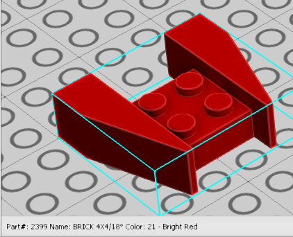

You can use part 50373 instead, it is almost identical and has the two extra studs on the top, in LDD. 2399 is no longer in production, anyway.
About 2399. Interesting! Has it always been like that?
I also noticed now that the tube on the underside is protruding further down then the side walls :wacko:. And that the top studed 2x2 surface is out of system heightwise (if you put a plate on it).
Well, you are right JGW3000. From what I've understood, the reason it is like this is because LDD uses the internal Brick categorisation structure at TLG, which is used also internally by designers, manufacturing etc. And in that structure, only new/current bricks get moved to updated categories. Therefore old and new versions of the same brick can end up in different categories.
But I agree...it is annoying and takes away a bit of the use of the categoires in LDD, if you can't trust them fully.
Has the original 4865 panel 1 x 2 been moved to a different category in this way, or has some "clever" individual completely erased it in favour of the updated version with rounded edges? (It appears the latter, and if so I have a few words in mind for said individual... :angry:)

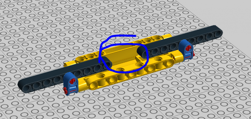

It seems there is a small bug with the new style curved panel
when i build the boom sections there is everything fine, but when i put the first stage in the mainbox the new panel type collides with something on one side. The old panel type would fit without problems, but it has not enough holes to get stable enough. does anyone know why this happens?
lxf
After some analysis, I found there seems to be a collision error in the inner "corner", circled in blue in the attached image. The black beams cannot be pushed any further in towards the middle.
I'll report the error and let's hope it gets fixed for the next brick update.
I removed all but one pin and rotated the panel to some 179,67 degrees :wink: Than I just reinserted the pins and copy pasted the panels.
