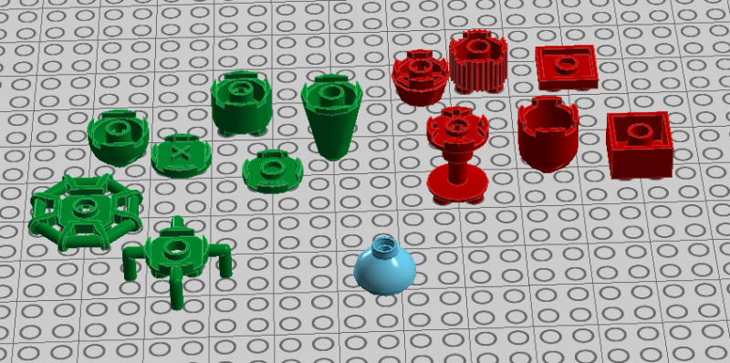

Lyichir Posted July 4, 2014 Posted July 4, 2014 Yeah, it seems to me that part 15395 turns out to need connectivity with all sorts of parts. The top rim ought to be able to connect to just about any 2x2 part, even square ones. But it seems like connectivity is only programmed for a few round parts. And it's not just a situation where you can float it into place—if connectivity isn't programmed, the rim will interfere with connections between parts. I'm going to try to make a list of parts which ought to be able to connect to the top of 15395. Most of these issues also affect part 2489, which has a similar rim: 2397 (the 2x2 section) 2399 (the front 2x2 square) 2422 2460 2622 (the front 2x2 square) 2680 (the center 2x2 square) 2904 2972 (the twelve 2x2 squares) 3003 3022 3039 3043 3045 3046 3068 3176 3300 3678 3685 3688 3729 3730 3787 3788 3956 (both the vertical and horizontal sections) 3961 4151 (the center 2x2 square) 4285 4598 (the vertical section) 4729 4858 (the front 2x2 square) 6032 6153 (the front 2x2 square) 6216 (the center 2x2 square) 6219 (the four 2x2 squares) 6232 15456 15647 17114 30000 30033 30094 30145 30151 30165 30389 30390 30499 30592 (the center 2x2 square) 40902 41751 (the front 2x2 square) 43713 43719 44375 45705 (the front 2x2 square) 47407 (the front 2x2 square) 48183 48933 (the front 2x2 square) 50990 51739 57908 57909 62712 63082 75341 75937 (this connection is used in the upcoming Exo-Suit, which is what led me to realize the extent of the issue) 87580 90194 92013 92582 93348 (the front 2x2 square) 93606 (the front 2x2 square) 94148 94531 (the front 2x2 square) 98284 99206 This is far from a a complete list. I only have time now to check categories up through modified plates (the plate with clip category) and even then I may have missed some. As you can see, this is a wide-ranging issue. I hope for this sort of connectivity to be added in future updates. Quote
Superkalle Posted July 4, 2014 Author Posted July 4, 2014 Yeah, it seems to me that part 15395 turns out to need connectivity with all sorts of parts. The top rim ought to be able to connect to just about any 2x2 part, even square ones. But it seems like connectivity is only programmed for a few round parts. And it's not just a situation where you can float it into place—if connectivity isn't programmed, the rim will interfere with connections between parts. Yes, connectivity is only on case-by-case since it turned out many bricks will not fit in real life. 30151 is too lose 2x2 plate is too tight 2x2 brick is too lose etc The 15395 is actually a very odd (and poor standardized) brick since the connectivity is case by base, and that goes against one of the core fundamental principles of the LEGO system - that what looks like it should fit (for a child), should fit. Having said that, if there are some connections that should fit but don't in LDD, report them here (as always), but make sure to test them with physcial bricks first. And I agree that 75937, and most likely it's old counterpart 30333, should fit. I also tested 30094 just now, and that fits fine, so that get's reported too. Quote
Lyichir Posted July 4, 2014 Posted July 4, 2014 Yes, connectivity is only on case-by-case since it turned out many bricks will not fit in real life. 30151 is too lose 2x2 plate is too tight 2x2 brick is too lose etc The 15395 is actually a very odd (and poor standardized) brick since the connectivity is case by base, and that goes against one of the core fundamental principles of the LEGO system - that what looks like it should fit (for a child), should fit. Having said that, if there are some connections that should fit but don't in LDD, report them here (as always), but make sure to test them with physcial bricks first. And I agree that 75937, and most likely it's old counterpart 30333, should fit. I also tested 30094 just now, and that fits fine, so that get's reported too. The real problem is not that they don't connect, but that they literally collide if you try to place them as if they were connected. This is a huge problem, since all it takes are two 1x1 round plates to position even most parts which would normally be too loose as if they were "connected". If there's not a collision in real life, there shouldn't be one in LDD. And for the record, I tried with both the 2x2 plate and 2x2 brick and BOTH worked without any substantial stress on the parts. I didn't test all of these physically (that would take days, given the current state of my collection) but I would certainly expect the majority of them to work without issues. Quote
Superkalle Posted July 4, 2014 Author Posted July 4, 2014 The real problem is not that they don't connect, but that they literally collide if you try to place them as if they were connected. This is a huge problem, since all it takes are two 1x1 round plates to position even most parts which would normally be too loose as if they were "connected". If there's not a collision in real life, there shouldn't be one in LDD. OK, I think I'm starting to understand you now. But in the Reid Exo-suit, I thought you meant, that the 15395 were lacking stud connectivity to 75937, and that that was the bug. It was when you went on and listed all the other bricks, that I said that not all of them should have stud connections. I'm aware about the problem with the 1x1 round plate and how it allows a lot of scaffolding possibilities, but fixing all possible bricks in all possible connections so that they don't intersect is going to be a humongous task, so I'm reporting only those that are specifically messing up the re-creation of an official set, or could be deemed very common And for the record, I tried with both the 2x2 plate and 2x2 brick and BOTH worked without any substantial stress on the parts. I didn't test all of these physically (that would take days, given the current state of my collection) but I would certainly expect the majority of them to work without issues. Maybe we are talking past each other. As an example, there is no connection between a 2x2 brick and a 15395 (no clutch power), so therefore it will not connect in LDD (or in real life). And with a 2x2 plate the connection is too strong (not legal), at least with newer ones (all the ones I've tried) due to the mold ejection holder marks along the inner sides, and therefore it is not supported in LDD, and not in real life either. As examples, the Red bricks shall not fit, the green ones should. Is that the way you view it too? Quote
Lyichir Posted July 5, 2014 Posted July 5, 2014 (edited) OK, I think I'm starting to understand you now. But in the Reid Exo-suit, I thought you meant, that the 15395 were lacking stud connectivity to 75937, and that that was the bug. It was when you went on and listed all the other bricks, that I said that not all of them should have stud connections. I'm aware about the problem with the 1x1 round plate and how it allows a lot of scaffolding possibilities, but fixing all possible bricks in all possible connections so that they don't intersect is going to be a humongous task, so I'm reporting only those that are specifically messing up the re-creation of an official set, or could be deemed very common Maybe we are talking past each other. As an example, there is no connection between a 2x2 brick and a 15395 (no clutch power), so therefore it will not connect in LDD (or in real life). And with a 2x2 plate the connection is too strong (not legal), at least with newer ones (all the ones I've tried) due to the mold ejection holder marks along the inner sides, and therefore it is not supported in LDD, and not in real life either. As examples, the Red bricks shall not fit, the green ones should. Is that the way you view it too? It's possible that the plate and brick I attached the piece to were older varieties. While I'm a stickler for that sort of thing on LDD I'm afraid sorting out my physical collection is a daunting enough challenge without distinguishing newer versions of what is more or less the same mold. With parts that would be too tight a connection, the lack of connectivity is understandable (even if it's not always obvious from the renders of these parts on LDD). But parts where there isn't enough clutch power should still be able to be positioned as if connected, since all it takes to connect most of those parts (specifically, those 2x2 parts with a center tube) is to place two 1x1 round plates on the inside of 15395 to "connect" the parts via the center tube of the part on top. Indeed, from my experience this technique is used to strengthen the connection of 15395 with even most of the parts on the left of your image (an example being the "lights" on the underside of the roof of the Simpsons House). The fact that this sort of connection needs to be programmed in individually, meanwhile, is probably the main reason Duplo parts are not yet available on LDD (since the connections in both of these situations are based on the inside geometries of bricks, which are not themselves programmed as boundaries). I can only hope that if LDD 5 is ever released it might make these sorts of connections simpler. Edited July 5, 2014 by Lyichir Quote
Superkalle Posted July 5, 2014 Author Posted July 5, 2014 With parts that would be too tight a connection, the lack of connectivity is understandable (even if it's not always obvious from the renders of these parts on LDD). But parts where there isn't enough clutch power should still be able to be positioned as if connected, since all it takes to connect most of those parts (specifically, those 2x2 parts with a center tube) is to place two 1x1 round plates on the inside of 15395 to "connect" the parts via the center tube of the part on top. Indeed, from my experience this technique is used to strengthen the connection of 15395 with even most of the parts on the left of your image (an example being the "lights" on the underside of the roof of the Simpsons House). OK, finally I see what you mean by when you mention the Simpson house example. That was an interesting example BTW, because the 1x1 round plate "light bulbs" inside will not be visible from the outside. I wonder, was it added only to give a cool experience during building (i.e. the builder will know there are are bulbs inside the lamp shade)? Because it doesn't seem reasonable that the two 1x1 round studs are added for strengthening the connection since there are no forces on the lamp shade (other then gravity). As for the all the other examples in your list - now they are beginning to make more sense. Hm, not sure what to think now. We'll have to see how common building techniques this turns out to be. Are there any other example then the Simpson house? And like I said, all of the candidates in your list have to tested to at least see they are not a too tight fit. Or that won't fit at all due to physcial obstructions in the physcial brick - like in 4285. The fact that this sort of connection needs to be programmed in individually, meanwhile, is probably the main reason Duplo parts are not yet available on LDD (since the connections in both of these situations are based on the inside geometries of bricks, which are not themselves programmed as boundaries). I can only hope that if LDD 5 is ever released it might make these sorts of connections simpler. I think that for the DUPLO case, it was just deemed that LDD was not suited for such small kids, so there was no need to add DUPLO bricks. But that's just my guess - I don't know for sure. Quote

Lyichir Posted July 5, 2014 Posted July 5, 2014 OK, finally I see what you mean by when you mention the Simpson house example. That was an interesting example BTW, because the 1x1 round plate "light bulbs" inside will not be visible from the outside. I wonder, was it added only to give a cool experience during building (i.e. the builder will know there are are bulbs inside the lamp shade)? Because it doesn't seem reasonable that the two 1x1 round studs are added for strengthening the connection since there are no forces on the lamp shade (other then gravity). As for the all the other examples in your list - now they are beginning to make more sense. Hm, not sure what to think now. We'll have to see how common building techniques this turns out to be. Are there any other example then the Simpson house? And like I said, all of the candidates in your list have to tested to at least see they are not a too tight fit. Or that won't fit at all due to physcial obstructions in the physcial brick - like in 4285. I think the use of the plates in the Simpsons House set are because the bowls would otherwise be "hanging" from the roof segments, being attached to the underside of the segment rather than on top, the way Lego models are commonly built. The plates likely provide a bit of extra stability. I think that for the DUPLO case, it was just deemed that LDD was not suited for such small kids, so there was no need to add DUPLO bricks. But that's just my guess - I don't know for sure. Either way I hope that at the very least basic Duplo bricks are someday added to the software. Not only would it be nice for, say, if you want to design a model with one of the old promotional printed 1x2x2 Duplo bricks in it (one of the few types of Duplo that has commonly been marketed toward fans of all ages), but larger AFOL models (especially things like mountainous landscapes with large raised sections) often use Duplo bricks for a light, cheap substructure. Specialized Duplo parts would just be the icing on the cake, for when you REALLY want an NPU. Quote
