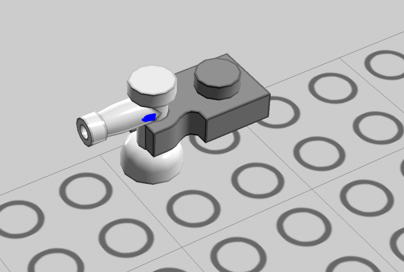

I have been working on a Fire Station MOC & I have come accross a bug that I have checked in some older models to see if it happen within them.
Part 4599 (http://www.bricklink...Item.asp?P=4599) Tap diameter 4.9/6.4 will not attach to Minifigure hands, in the older models it comes up as a misplaced brick & removes them.
I have been able to position them using 'scafolding'.
I think I know the reason for that.
If you place a normal clip onto the tap, it should not attach any further then the lowest portion. If you place it higher up, the area highlighted in blue in the picture, would force the clip to bend apart, and that is an illegal technique since it would force the clip to brake eventually. When this limitation was added, it seems the Minifig-hands got included too, and maybe they shouldn't.
Yes there is a small gap,but that is were it snaps too.
The other side is alined and fitted correctly.
Download file
I've checked your file. As Zblj suggested, move the Cross Block and the Bush a bit up and everything will be connected.
Edited by mzoli
