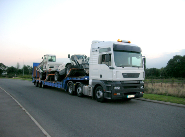

dolittle Posted October 19, 2010 Posted October 19, 2010 Hi, First, amazing! the detail is truely done in expertise and care. In real life the Lowloader is re-enforced to make sure it doesn't bend as can be seen in the picture, the bending in LEGO might not do much, but in real life, such bending would mean stress on the metal and eventual break of the metal bars. In LEGO life it would mean that the forward and backward wheels will not be at full contact with the ground, causing reduced steering capabilities. I would suggest re-enforcing the lowloader, by adding two wheels just a few cm after the truck's last wheels (just after the connector) - so that it sits/connects OVER the wheels, rather after, this will reduce the stress on the bars of the lowloader, and put some/most of the weight on the wheels (see my picture #2) Like this: And this: Quote
