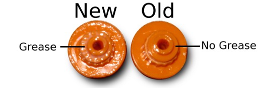

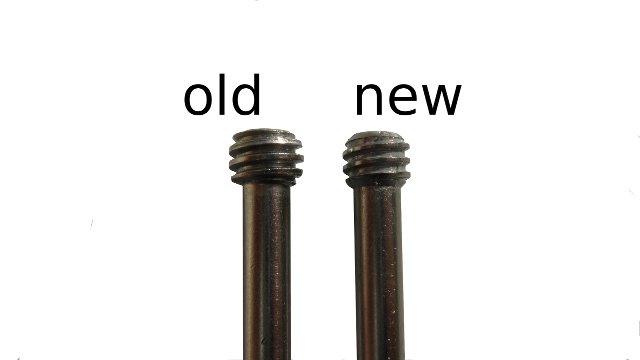

fmmjqtft Posted October 2, 2010 Posted October 2, 2010 (edited) The service bag has now arrived, so I have dismantled and compared an old and a new LA. The new LA is almost identical to the old one; it still takes the same number of rotations to extend; it still extends to the same length; there is still a clutch. I have cut the white plastic sleeves into pieces to look at their teeth, and from what I can see, the sleeve is identical on both LAs. There seems to be only one change; the 'tooth' of the screw in the new LA is significantly smaller. Performance changes: -lower friction -the new LA rattles less when extending/retracting -the new LA is much quieter -the new LA extends/retracts more smoothly, especially at high speed Unfortunately, because the new LA has a thinner 'tooth', the new LA bends more when fully extended. The end of the rod can move by an extra mm in each direction. It is not actually as bad as the photo suggests, but is still noticeable. Edit: There is also much more grease in the new LA. Grease has been applied inside the sleeve, inside the clutch and between the orange part and the outer casing. The plastic was also much harder to cut away on the newer LAs (more glue), which is why the two dark grey pieces look different in the picture below. Edited October 4, 2010 by fmmjqtft Quote

allanp Posted October 3, 2010 Posted October 3, 2010 (edited) For those of you that use them (not me!) I hope the smaller pitch of the thread does not shorten their life span. The sideways play would also suggest that the full depth of this already small pitch is not used. I guess now we know that a smaller surface area DOES reduce friction Once again I have to say kudos to TLG for doing this so fast and without fuss. Edited October 3, 2010 by allanp Quote
fmmjqtft Posted October 3, 2010 Author Posted October 3, 2010 On 10/3/2010 at 8:38 AM, allanp said: For those of you that use them (not me!) I hope the smaller pitch of the thread does not shorten their life span. The sideways play would also suggest that the full depth of this already small pitch is not used. I guess now we know that a smaller surface area DOES reduce friction Once again I have to say kudos to TLG for doing this so fast and without fuss. The thread pitch is the same. The only difference is that the thread is much thinner (it does not stick out as far from the rod). As you said, the smaller surface area of the thinner thread reduces friction. Quote
allanp Posted October 3, 2010 Posted October 3, 2010 (edited) On 10/3/2010 at 9:23 AM, fmmjqtft said: The thread pitch is the same. The only difference is that the thread is much thinner (it does not stick out as far from the rod). As you said, the smaller surface area of the thinner thread reduces friction. Sorry, my mistake, yes the pitch is the same, I meant the thread height is less. I was getting my terms a bit mixed up as per usual Edited October 3, 2010 by allanp Quote

hoeij Posted October 6, 2010 Posted October 6, 2010 On 10/2/2010 at 8:38 PM, fmmjqtft said: There seems to be only one change; the 'tooth' of the screw in the new LA is significantly smaller. ... Edit: There is also much more grease in the new LA. ... Has anyone else compared the lifting capabilities of the old LA versus the new LA? I did a very rough comparison: In the 8043B model, I counted how many wooden blocks it could lift with the old LA's, versus how many with the new LA's. This lead to a rough estimate that the new LA's lift about twice as much weight (using the same M motor). My measurement is not very accurate though because I did not carefully compare the torque. Has anyone done a more precise measurement? (comparing the lift, while making sure to use the same torque in both measurements?). I'm also wondering about something else: Assuming for the moment that a more precise measurement would still show a difference in performance between the old and the new LA, then the question is: What causes this difference? Is the performance difference solely due to the grease, or does the new screw contribute as well? To figure out this question, we'd have to compare "an old LA with some grease added" with "a new LA". Dluders, you've mentioned that you lubricated some LA's with olive oil, do those lubricated old LA's have the same performance as the new LA's? For instance, the front-loader with lubricated old LA's, using the same amount of torque, does it lift the same weight as it does when you put new LA's into it? (looking at the picture in the first post, it looks like there is no need to add lubrication to the new LA's) Quote

fmmjqtft Posted October 7, 2010 Author Posted October 7, 2010 On 10/6/2010 at 3:17 PM, hoeij said: What causes this difference? Is the performance difference solely due to the grease, or does the new screw contribute as well? This could be tested by trying the old LA's screw inside the new LA's sleeve (which has grease). Unfortunately, this would require destroying yet another new LA for the sleeve. Quote
