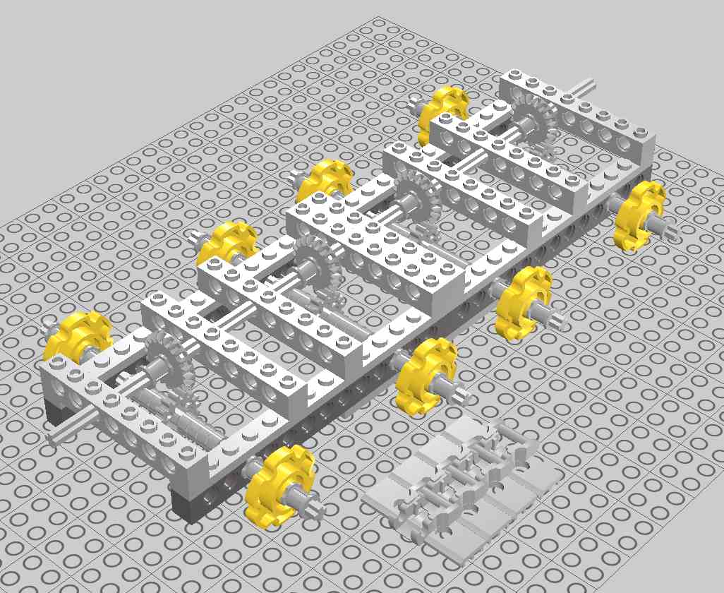

Im trying LDD for the first time but i am very compentent with CAD programs (its my job) and im having a bit of a problem.
Im trying to make a tracked vehicle (like a tank) but i cant get the tracks to connect to the wheels, i am using the sprocket for the track wheels. Im not sure what im doing wrong.
Image attached
First of all you dont have enough room for tracks, they are 5 studs wide and you gave them 4 studs width. Secondly tracks dont attach to wheels, but with some work arround you can place them under wheel, and just keep on adding and rotating tracks around.
Edited by Zblj
