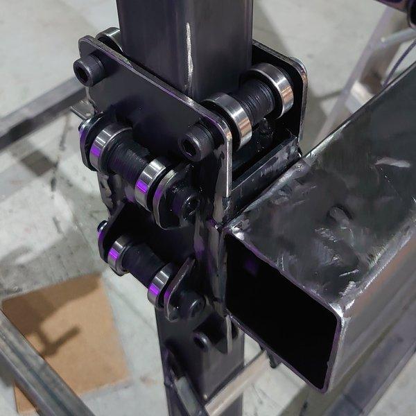

Here is a real 4 sided roller around some square tubing, these use 2 rollers per side which I probably don't need:
