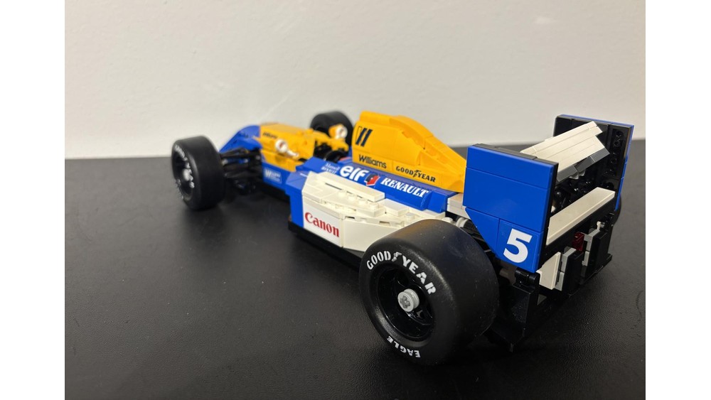

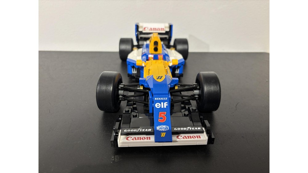

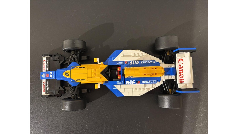

I have now motorized another Icons/Creator Expert Veichles.(i have done 16 of them now)
I always try to make the motorization as invisible as possible, you should not be able to see any electronics without looking very carefully.
As an F1 is so small and compact, I had to make some smaller visible changes to be able to fit Buwizz and motors
Steering wheel is still working, but the fake engine had to be removed.
I have also motorized the McLaren, so now I can run a F1 Gran Prix in the living room:)
Motorized with Buwizz and 2 PF M-motors.
Instructions available at Rebrickable.
Youtube video

It would have been good to include some pictures, how motorisation is done, as topic is about that. Now this topic looks like just advertising for instructions.
Edited by Jurss
Great MOC!
I would also be interested/curious to see more details of a MOC which is looking great "from the outside" already.
@Jurss seems there also no more pictures offered of the internals on the RB moc page.
Agree that technical details would be nice.
By 2 PF M motors, you mean 2 for drive, or 1 for drive, one for steering? Or why is it just on-off steering?
I have added pictures of the locations of motors and battery. I think this is on the edge of what is possible to motorize with Lego motors(if you not count the very rare micro motors)
12 hours ago, aFrInaTi0n said:
Great MOC!
I have added more pictures in another reply.
There is one M motor for drive and one M motor for steering. There is a simple return to center mechanism for the steering that works fairly good, but are not perfect. There is just not much space to make it any better.
Woah, I skipped over this at first as "just" another good-looking F1 car, but now seeing those pictures of the motorization, I'm seriously impressed!
Thank You! Now its clear, where electronics have been squeezed.
