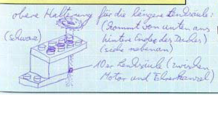

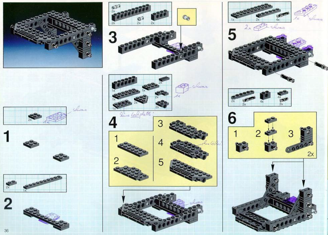

Chilly Posted March 21 Posted March 21 Several years back, I bought a used 8880 Super Car, which didn't come with instructions. Before I built it, I found a paper copy. In the meantime I downloaded the instructions from Peeron/PICSL and had them printed and bound. I've built the car a number of times, but never used the downloaded instructions. I am now building the car again, and this time using the downloaded instructions (spiral binding is great, the book stays flat and you can fold it back on itself). I have now got to a page with handwriting on it, that I cannot read - my german? is not very good. Can anyone make sense of the below pictures, or can translate? 8880 Handwriting 1 8880 Handwriting 2 Quote
Woodstock89 Posted March 21 Posted March 21 Is this a MOD to add HOG steering to this model? Let me try: "schwarz" = black "obere Halterung für die längere Lenksäule: (kommt von unten aus hintere(m) Ende des Daches)(siehe nebenan)" --> Upper mount/bracket for the longer steering column: (comes from below from the rear end of the roof) (see next page) "10er Lenksäule (zwischen Motor und Fahrerkanzel)" --> 10L steering column (=axle, I presume) (between engine and driver's cockpit) "keine Lochplatte" --> use the corresponding plate without holes Quote
Auroralampinen Posted March 21 Posted March 21 5 minutes ago, Woodstock89 said: Is this a MOD to add HOG steering to this model? Let me try: "schwarz" = black "obere Halterung für die längere Lenksäule: (kommt von unten aus hintere(m) Ende des Daches)(siehe nebenan)" --> Upper mount/bracket for the longer steering column: (comes from below from the rear end of the roof) (see next page) "10er Lenksäule (zwischen Motor und Fahrerkanzel)" --> 10L steering column (=axle, I presume) (between engine and driver's cockpit) "keine Lochplatte" --> use the corresponding plate without holes Well the 8880 had a hog steering out of the box it was located on the engine room:) Quote
Woodstock89 Posted March 21 Posted March 21 Now you made me google it ;-) I owned the 8880 long time ago and, indeed, I completely forgot about the HOG. Quote
amorti Posted March 21 Posted March 21 Vaguely interesting to see what notes somebody made themselves perhaps 30 years ago... but you could also just use the official uploaded instructions. https://www.lego.com/cdn/product-assets/product.bi.core.pdf/877169.pdf Quote
lcvisser Posted March 21 Posted March 21 This looks like a MOD to get the HOG steering wheel (little black wheel with tire) higher up, almost on the roof of the cabin. The original build had this wheel just above the engine, and you had to reach inside a bit to reach it. I imagine that it would be hard to reach with bigger (adult) hands, prompting this MOD. Quote
Chilly Posted March 21 Author Posted March 21 21 minutes ago, lcvisser said: This looks like a MOD to get the HOG steering wheel (little black wheel with tire) higher up, almost on the roof of the cabin. The original build had this wheel just above the engine, and you had to reach inside a bit to reach it. I imagine that it would be hard to reach with bigger (adult) hands, prompting this MOD. Yes, I think you're correct. The HOG is a bit low and awkward to operate. I have all the extra pieces lined up on the table, so will have a go and see what it does. 1 hour ago, amorti said: Vaguely interesting to see what notes somebody made themselves perhaps 30 years ago... but you could also just use the official uploaded instructions. https://www.lego.com/cdn/product-assets/product.bi.core.pdf/877169.pdf I've got the original book, just wondered what this mod was. Going to have a go. Quote
