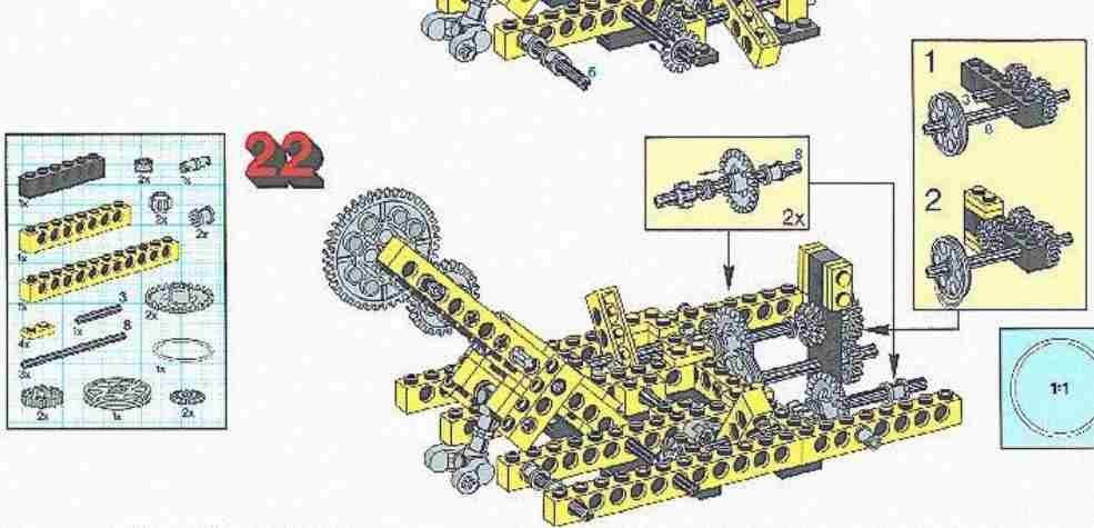

To prevent the propeller from changing direction, the trick from Control Center 8094 could work. Place 3 gears on a lift arm that can rotate and is therefore able to support two different transmission paths. This is probably not possible with the set due to space constraints and the available parts, but perhaps it will fit into another MOC at some point :)
