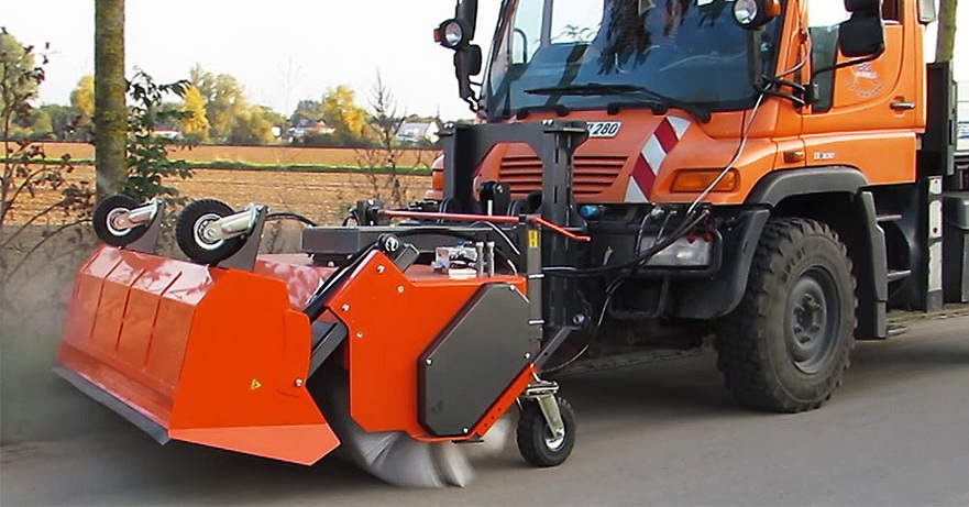

If the attachment needs to be fixed to the truck (without swiveling), then maybe you can use one of these two solutions:
1.
You can leave it as is, and instead of the current wheels, add a set of swivel wheels, like those on the shopping carts:
They will allow for the attachment to move together with the truck, and the axle that is powering the attachment can be routed via the truck's back axle.
2.
You can leave it as is, and instead of the current wheels, add a set of steering wheels. Their steering angle should be larger than that of the truck's front axle.
