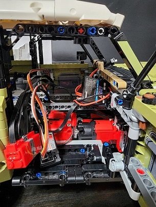

15 hours ago, Lixander said:
I see. i asked because I burned 3x MouldKing buggy motors with a 2100mAh 30C 2S Li-Po, but I took out their thermistors. With the thermistors on, the motors wouldn`t run at all with that battery.
I've been using RC components with 3s Li-Po using 4-L motors in my Land Rover and it has been working fine. It generates enough power for me to drive indoors and outdoors.
Now the other problem I'm facing is the same as you. I've tried running dual buggy motors in my builds and in all occasions it would burn the PF plastics using 2s or 3s. The only scenario where I could run dual buggy motors safely is when I use the steering wheel hub with planetary gear reduction.
Well, 3s Li-Po might burn the motors themselves in time, as the 11.1V is close to the maximum of 12V. Also, I didn`t managed to burn any PF connector, just one but because of a short-circuit from what I remember. In my case, the actual motors got fried and 2x of them had RC wires and connectors. Buuut all of the 3x buggy motors I burned had the thermistor removed. I tested a 4th one with the thermistor on and it wouldn`t work.
Anyway, from what I have heard, the L motors can cope with a RC system and have similar performances with the buggy motors.
And by the way.........nice set-up ;)
