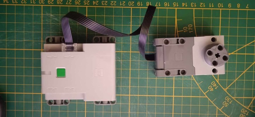

I've purchased parts 88017 and 88012 at an auction site. Supposedly original LEGO and new. They came in these simple white boxes.

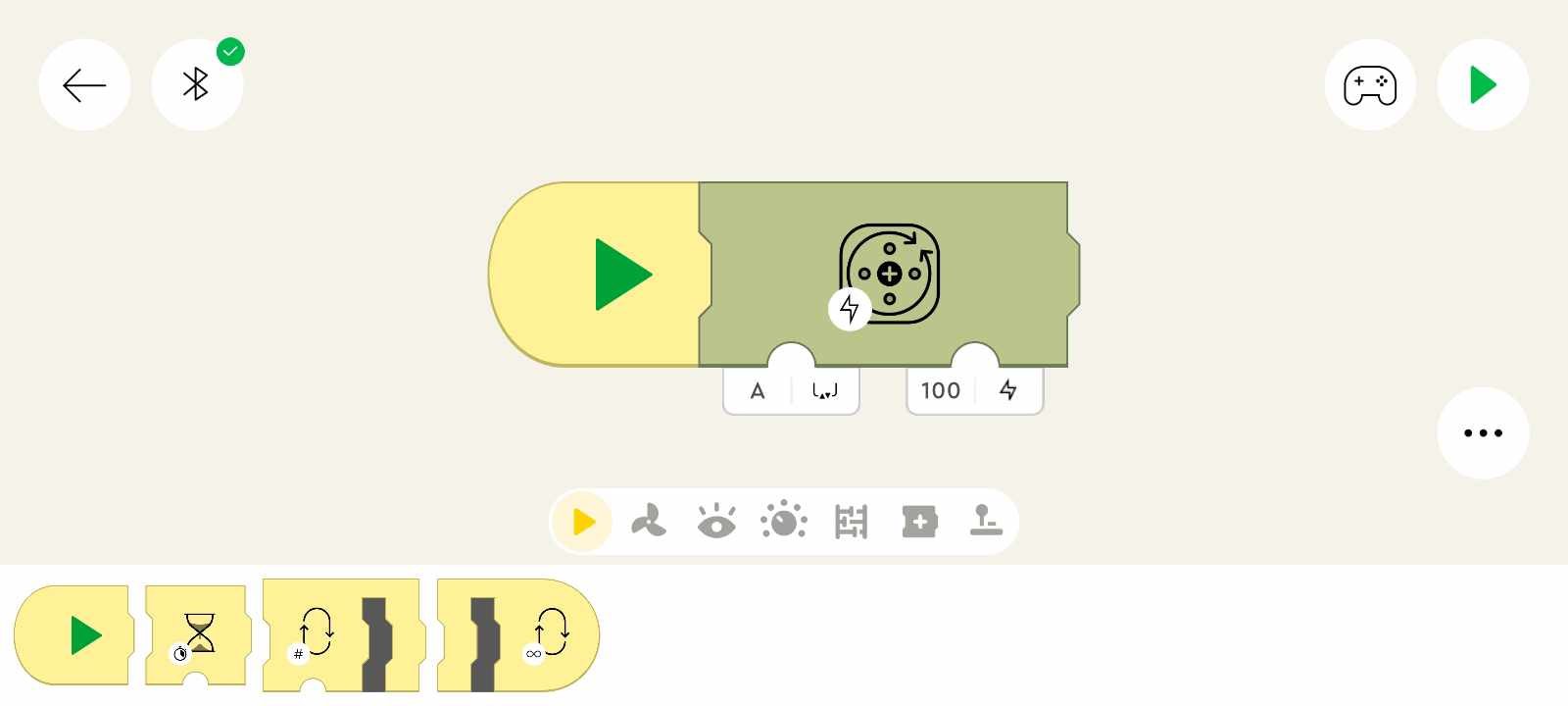

I'm trying to move the motor in any way using the Powered Up application. The hub lights up blue and connects normally in the application. I provide the simplest possible setup in the app, click Play and wait, but I am unable to move the motor at all.
Anyone know what might be going on? I feel like it must be some simple problem, but I can't figure it out. Is it possible to safely connect power directly to the motor cable without hub to check whether the motor itself is working?
I think the program starts the motor and then immediately the program ends - and stops all motors.
Put the hourglass behind the motor block, what happens?
