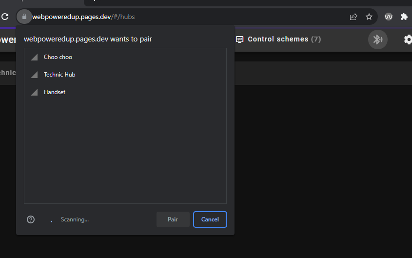

Lok24 Posted September 14, 2023 Posted September 14, 2023 (edited) On 9/14/2023 at 12:48 AM, glowytheglowbug said: ooh kinda like pybricks i guess, Expand I think no, it's completely different. With Pybricks you do programming, program resides in the hub No External device needed while controlling WebPoweredUp "only" translates commands while controlling the model. And you configure what actions (press button) result in action (run motor A) Device with browser needed while controlling. @nvsukhanov Great work, can start (chrome), can easily add Controllers (oops, writing this my PC Keybord popped up....) Brilliant. But how to "connect" a hub and the remote? Is there an example I could Import? A short description? Edited September 14, 2023 by Lok24 Quote

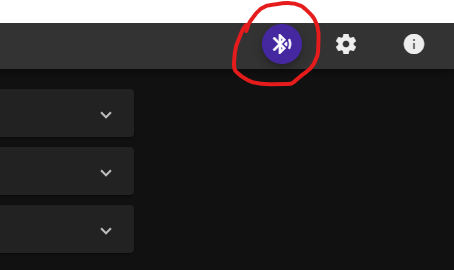

nvsukhanov Posted September 14, 2023 Author Posted September 14, 2023 (edited) On 9/14/2023 at 7:42 AM, Lok24 said: I think no, it's completely different. With Pybricks you do programming, program resides in the hub No External device needed while controlling WebPoweredUp "only" translates commands while controlling the model. And you configure what actions (press button) result in action (run motor A) Device with browser needed while controlling Expand @Lok24 , you are absolutely correct! Quote But how to "connect" a hub and the remote? Expand Thanks for your feedback! Guess I should've composed a manual (and I will definitely do). In a meantime, that one small button on the toolbar should initiate device discovery process (see attached pictures). Just importing control scheme won't help because control scheme bindings are "bound" to hub by it's unique id. After importing you can replace "bounded" hub with the hub that you have discovered&connected, but that will require such hub. Anyway, here's a sample control scheme import string, just in case: 0:3YCAgIJfgYCAgICAgIC9CArit6jM4OQ6Z8Ygr0y3Bq3N/aZxhB/CiFEE1mBrLiOP3j5fzMhDimX9p8D8GGlnMUoMf5V3N9Pu6V7Zxj0zPmPowOo9uGtfHhnoEmH3sUbr2zy05pAcDKgT0wV2Vk/+yPZS3KolkL3xPqJdNPXQtJj3cnNUNjVz7dHOQWZ0mrszG4aVkLctDVj7TzEZrb8egpideEWYIrVc5eJyFXOymY7JwoRX5K5OdeC/U5Mkf6xQ7hwjFvezBoIyQLZVOnFyRMlRRaEXut+X+SCtY8PtEDiRwVzEkwHN6yeebtd0Gyuq3fr8EbO1K7Vkf38k9uaA Edited September 14, 2023 by nvsukhanov added second picture with hubs list Quote
Lok24 Posted September 14, 2023 Posted September 14, 2023 @nvsukhanov Thanks, helpful! No "manual" needes - at the moment -) Here it is: And yes, it Works! Immediately. Great. How to run a motor permanently? (is "milky way" the same time zone as Berlin?) Quote

Lok24 Posted September 15, 2023 Posted September 15, 2023 (edited) On 9/14/2023 at 9:55 PM, 2GodBDGlory said: I couldn't get my Bluetooth controller to connect, Expand There are two steps: - click the BT-button in WebPoweredUP - window with all available BT-Devices opens - select one and pair Does your controller appear in this list? (mine does not .....) Then it is an issue between OS, Browser and controller, and has nothing to do with the program. Edited September 15, 2023 by Lok24 Quote

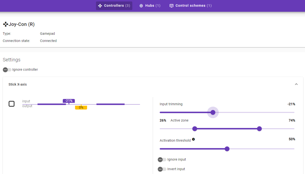

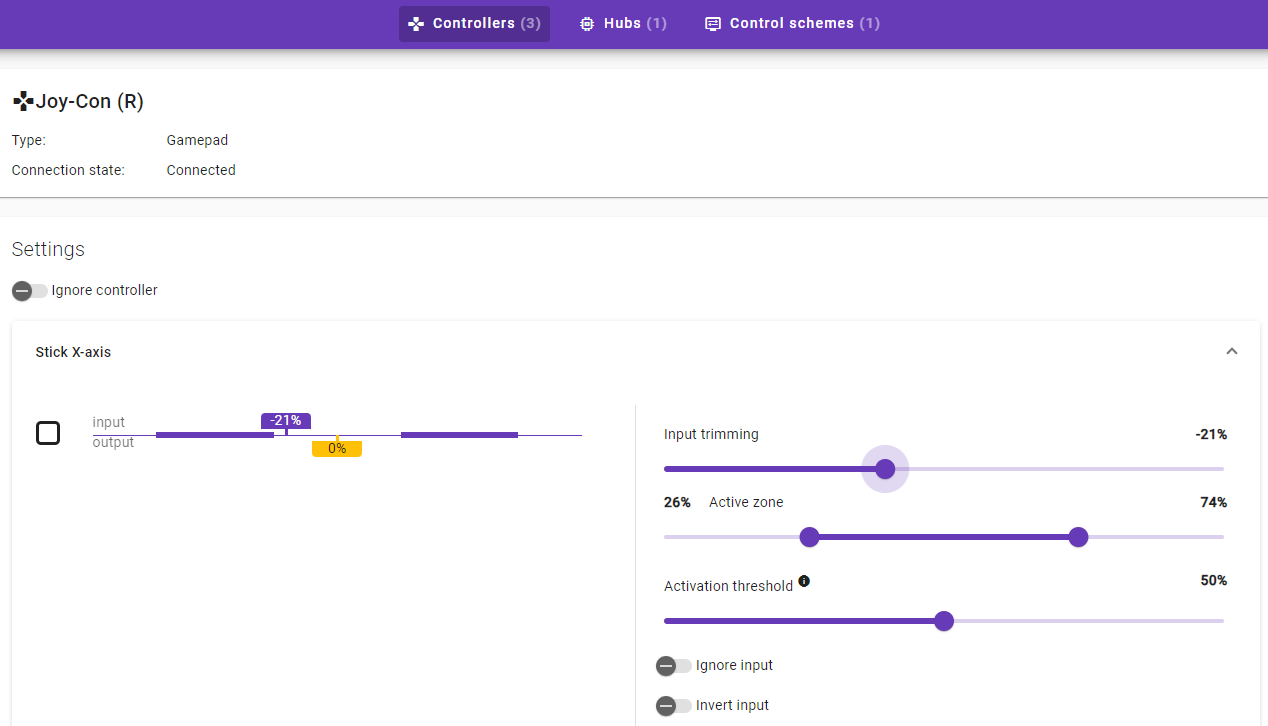

nvsukhanov Posted September 27, 2023 Author Posted September 27, 2023 On 9/15/2023 at 9:15 PM, 2GodBDGlory said: Well, I got the controller paired now, but binding things to its controls doesn't seem to work very well. Whenever I try to set a bind, it pretty much just defaults to either the left or right on my D-pad, and it just immediately binds to that, and doesn't give me the opportunity to bind to any other control, or to any key on my keyboard. Then, even when I got drive bound to the left and right on my D-pad, it was running something like -63% speed with one button and -27% on the other one, and I don't see where I could have accidentally input something to make that happen. The controller I'm using is a EVO VR MIC-VGP02-101. Expand @2GodBDGlory, many thanks for your feedback. I have attempted to address the issues you've encountered by introducing new gamepad configuration options. Off-center values can now be mitigated through the 'input trimming' option for button and axial inputs. The latest update also includes several bug fixes, enhancements to accessibility (although there is still much work to be done in this area), reduced latency, an increase in connection stability, and minor UI tweaks. Also I've changed the project name (links in the first post have been updated). The latest version of the app is available at both the old and new URLs. Quote
2GodBDGlory Posted September 27, 2023 Posted September 27, 2023 On 9/27/2023 at 8:25 AM, nvsukhanov said: @2GodBDGlory, many thanks for your feedback. I have attempted to address the issues you've encountered by introducing new gamepad configuration options. Off-center values can now be mitigated through the 'input trimming' option for button and axial inputs. The latest update also includes several bug fixes, enhancements to accessibility (although there is still much work to be done in this area), reduced latency, an increase in connection stability, and minor UI tweaks. Also I've changed the project name (links in the first post have been updated). The latest version of the app is available at both the old and new URLs. Expand Cool, thanks! I'll have to give it another go soon Quote
