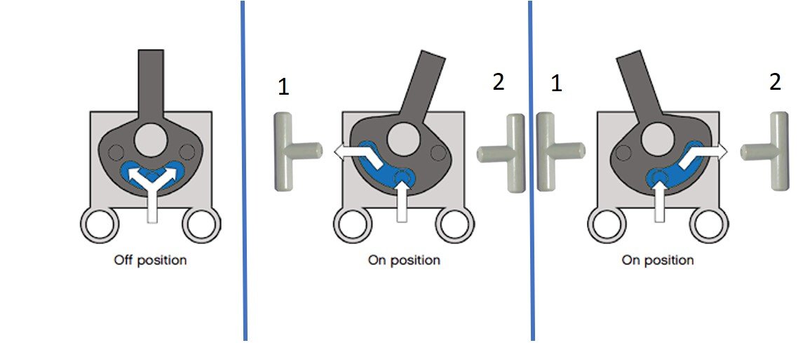

To pressurize two separate circuits you can use one valve. First pump up circuit 1, then circuit 2 and then just close it :)

Yes, this is what I wrote as a first idea, which is possible with today's parts. But the system could be simpler with proper parts, a simple valve that lets air through in one direction only (something like the manual pump must contain) would be sufficient in each circle, no switching required.

Such a valve does exist, in the classic distribution block part from the '80s! It's what I used in my video, which is now up and unlisted on YouTube!
