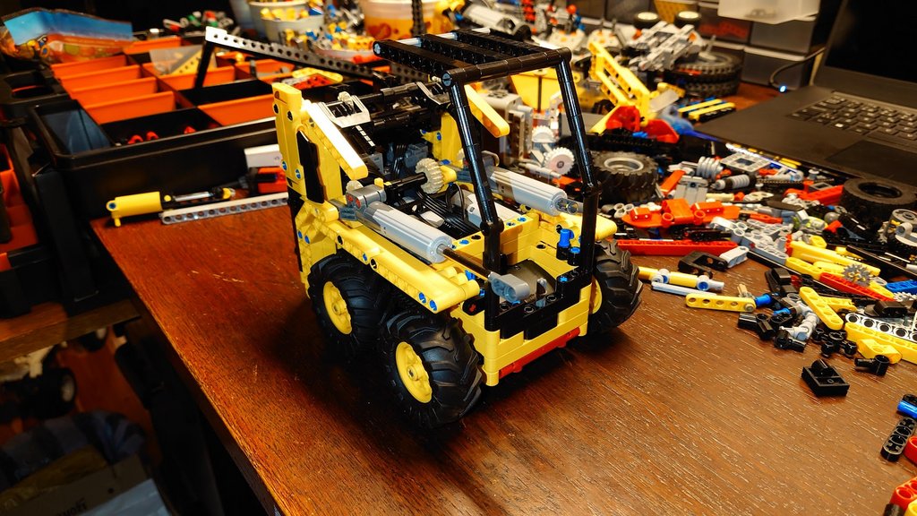

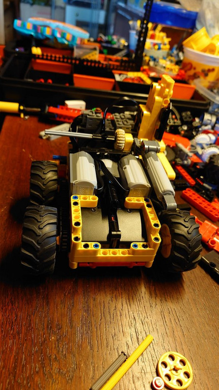

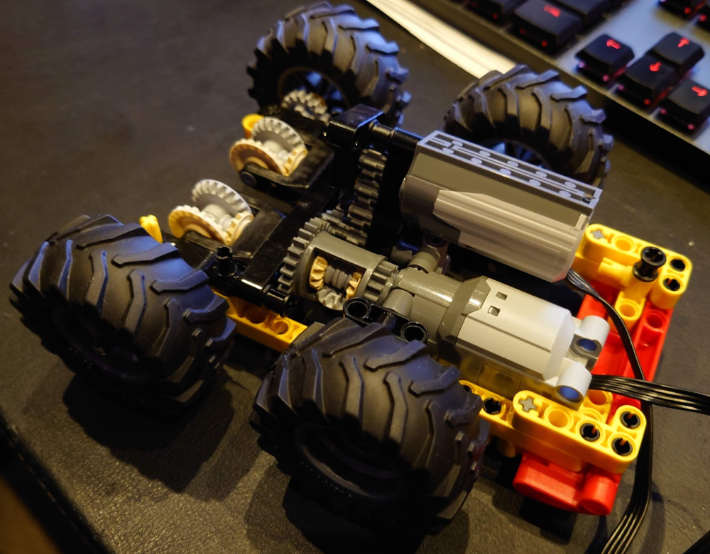

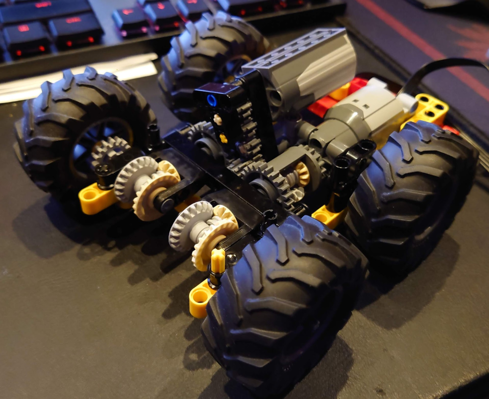

Nazgarot Posted April 9, 2022 Posted April 9, 2022 (edited) Finally a competition has drawn me out of a lull. Haven't really had time to build much the last couple of years, and lately I have laced the motivation to build anything at all. Then comes TC22 and I'm bubbling over with ideas. The first thing I thought of reading the rules was a skid steer loader. I'm going for a fully RC loader using BuWizz and 4-5 small PF motors. I'll also try to include an adder/subtractor to make it easier to steer. This is what I'm gunning for: I'm going to use the 42122 as a parts source for tires and a few other parts I lack. If I can solve the drivetrain issue... If not it will be a tracked loader. For now, this is what I have. I'm trying to keep within 17 studs with, and will compensate the other axis to keep within the allowed 10 000 cubic studs. I will update with more build pics as soon as possible. Haven't had time to do physical testing yet... EDIT - A few updates after starting physical build: It seems the completed size will be real close to the max 10000 cubic studs. Right now my goal is to keep within 28x17x21 = 9996 cubic studs. It's very hard making it less wide with these tires, and I will be needing the length to make sure the full bucket is within the box, so all I have left to play with is height. I could swap for some slimmer tires, but I feel these fit the model very well. But if I have to there are some alternatives. I decided to use an exoframe rather than an internal frame, and this allowed to make the adder/subtractor much more compact, and allowed me to switch to the one stud longer large motors. The plan is to use a chain to connect the front and rear wheels as this gives way less backlash. Now all I have to do is finding a way to implement the other two motors... Test build/prototype: First edition base after physical testing: _ED_ Edited April 15, 2022 by Nazgarot Quote
Jurss Posted April 10, 2022 Posted April 10, 2022 If You have two motors, why just don't use one for each side? Then You can remove those differentials, and have more space for other things. I think, it would be OK to use also these tires Then it would be narrower, and You would have more space in other directions. Maybe they would look somehow small for this scale? 10 hours ago, Nazgarot said: Test build/prototype: I don't see some 2 pictures after that line. Quote
Nazgarot Posted April 10, 2022 Author Posted April 10, 2022 (edited) 6 hours ago, Jurss said: If You have two motors, why just don't use one for each side? Then You can remove those differentials, and have more space for other things. I think, it would be OK to use also these tires Then it would be narrower, and You would have more space in other directions. Maybe they would look somehow small for this scale? As you say, those would be to small for the scale I'm going for. As for only using two motors, a part of the challenge I set for myself was including a adder/subtractor. Fitting only one motor for each side would allow for a much smaller scale, and would make it way easier... It being hard is a part of the reason I do this 6 hours ago, Jurss said: I don't see some 2 pictures after that line. I'll try uploading through a different service. Give me a heads up if it still doesn't work. Edited April 10, 2022 by Nazgarot Quote
SaperPL Posted April 10, 2022 Posted April 10, 2022 I think you need all wheels to be driven as otherwise the non-driven wheels will add resistance against steering. Quote
Nazgarot Posted April 10, 2022 Author Posted April 10, 2022 2 hours ago, SaperPL said: I think you need all wheels to be driven as otherwise the non-driven wheels will add resistance against steering. The plan is to drive the rear wheel through chain drive from the front wheels. This gives a lot less backlash then using gears, but I have to test it to see if the chain can handle the stress. If not I might have to convert it to tracks... Quote

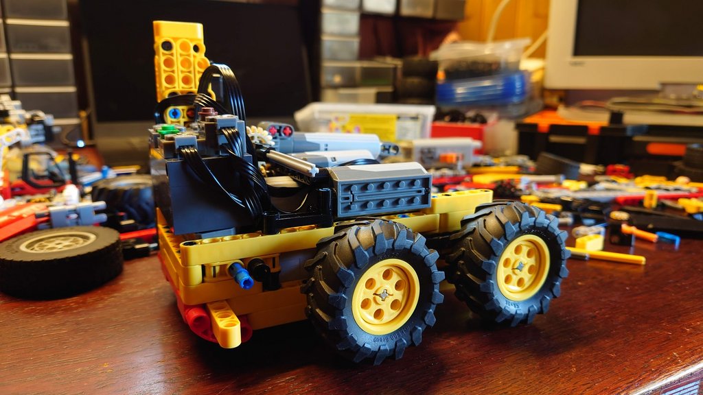

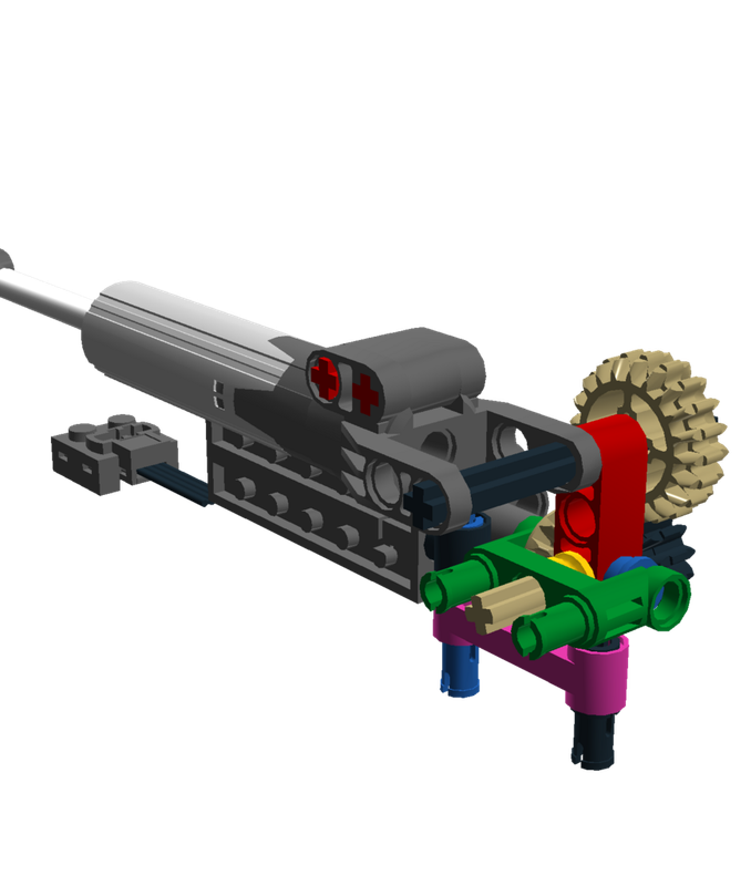

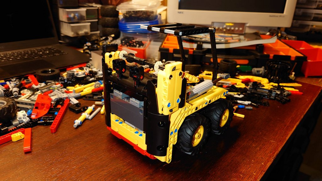

Nazgarot Posted April 15, 2022 Author Posted April 15, 2022 (edited) Some updates. I've decided to go with a Cat 216b as a base for the model. This involves using large LAs and making it quite a large model. I have to do a resize to 18x27x20 studs from the 17x28x21 I was planning for. Some progress - finally happy with the base of the vehicle, and pleased with how I managed to compress and cover up the adder/subtractor drivetrain. I've started work on the rear of the model and concepted a solution for placement of the last two motors. The last is giving me some challenges, but that is why we do this, isn't it? EDIT: Another small update: I needed to move power from a motor to a function (LA) to the opposite direction, 3 studs up and 3 studs to the side, and am quite pleased with what I came up with. As it might be of interest to others I will post it here. It uses one somewhat exotic part that I happen to have a lot of for some reason, and solves my problem for placing the motors within a very tight space. This solution holds the motor as well as the whole drivetrain in place, and only requires 4x3x3 studs. It also prevent gear skipping by holding the lliftarm in place with a 1x1 modified round plate. It makes for a super compact placement of the motors that will allow me to keep a somewhat realistic look within the limited dimensions. Now all I have to do is coming up with an equally compact solution for the other side... Then I'll have solved most of the mechanical issues, and only aesthetics are left. By the way, there is also the issue of placing the PF-power switch that I use to reverse one of the drive motors, and did not originally plan for... It's almost the size of a motor! _ED_ Edited April 22, 2022 by Nazgarot Quote

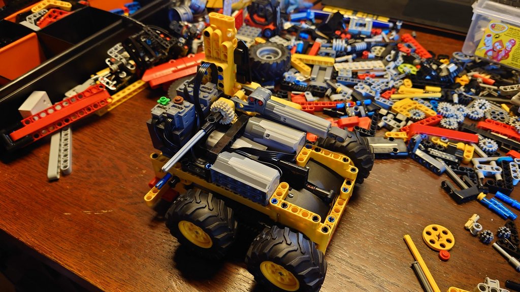

Nazgarot Posted April 21, 2022 Author Posted April 21, 2022 (edited) Another update. Now the base is almost done, and I have managed to find place for a total of 5 motors (2 Large ones for drive, 3 small for steering/lift/bucket), a complete adder/subtractor, the BuWizz, a PF switch, and still have kept everything low enough to have room for a full cabin. If I could find a way to control a sixth motor I could even include a opening bucket like some of these have. As you can see of the last picture the trackwidth gets quite wide with these tires. I'm at 18 studs now, and could reduce it to 17 using a trick by putting the inner side of the tire inside of the rim. But I don't know if this is legal according to the competition rules... I could also use other tires for 16 studs, and will probably include pics of the finished model with several different setups, but I feel these fit the model very well. I've also made a custom openable bucket that could be controlled if I find a way to control a sixth motor (5th function), but I lack parts to realize it at the moment, so I have to tear something apart before I can build it. Pics upcoming. Now all I have to do is finish the boom, the connection for the bucket, and the superstructure as well as the cabin. I do have one problem though... It is so rear heavy that it wants to tilt backwards. It was meant as a feature, but not to this degree... Any suggestions to fix it are welcome. _ED_ Edited April 21, 2022 by Nazgarot Quote
Mikdun Posted April 21, 2022 Posted April 21, 2022 37 minutes ago, Nazgarot said: I do have one problem though... It is so rear heavy that it wants to tilt backwards. Even after you add: 37 minutes ago, Nazgarot said: the boom, the connection for the bucket, and the superstructure as well as the cabin. It is still rear heavy? Make bigger bucket! Quote
Nazgarot Posted April 21, 2022 Author Posted April 21, 2022 It tips back as is, and I still have to add the seat, the control systems, the gear train for the bucket function, and the mounts for the boom. The weight of this will be far more than the boom and bucket, so it will be VERY back heavy, That in combination with 2x L motor for drive equals instant wheelies... Cool, but not exactly what I was looking for. Might be able to weight down the boom a bit, but I'm open for other suggestions... _ED_ Quote

Jurss Posted April 22, 2022 Posted April 22, 2022 Wheelbase is really short on your model. Real ones have shorter and littlebit longer wheelbases, depending on model. f.i. bobcat s530 has pretty long wheelbase for these type of machines. but, maybe with everything else added, it won't be so bad. Quote
Nazgarot Posted April 22, 2022 Author Posted April 22, 2022 12 hours ago, Jurss said: Wheelbase is really short on your model. Real ones have shorter and littlebit longer wheelbases, depending on model. f.i. bobcat s530 has pretty long wheelbase for these type of machines. but, maybe with everything else added, it won't be so bad. I know. It was meant as a feauture, as I'm basing the build on the Cat 226b As you can see it has a short wheelbase with a large overhang, and I thought this would make it possible to do some wheelies if you really jam the throttle. It also has a very low ground clearance in the back, making it ideal for a model with the drive motors very low. As is it is way to rear heavy. But going with a custom bucket should help some as it will be quite heavy compared to a standard single piece bucket. I'm even thinking of including opening the bucket as a manual function. Quote

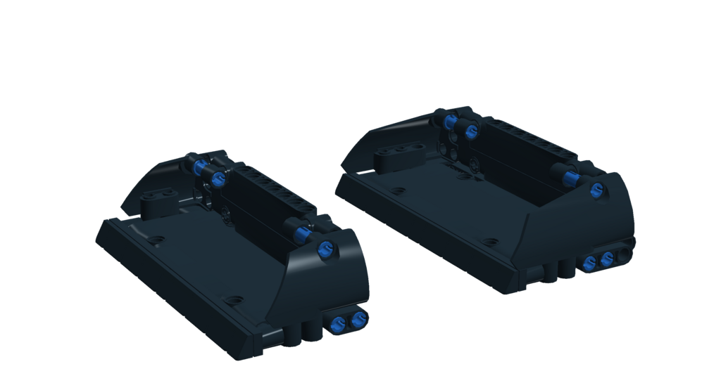

Nazgarot Posted April 24, 2022 Author Posted April 24, 2022 Haven't had time for any more physical building, but here are the bucket variants I'm considdering. Non of them are "perfect" copies of the real bucket, but both have a "hidden function" of being able to open. The overall shape is close to the real buckets, but I'm still undecided on which is best. Any inputs? I would also like suggestions for improvements if you have any... _ED_ Quote
