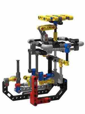

technicfanatic Posted March 4, 2022 Posted March 4, 2022 I'm building an educational model of helicopter flight controls (cyclic, collective rigging and swashplate) losely based on the Bell 206 (because I find the mixing crank pretty cool). I picked the Technic turntable as the heart of the model and the design started to get really large because I needed a gimbal to constrain the motion of the plate. (A bit like @jwarner's model here.) As an exercise, I decided to make the smallest reasonably non-kludgy model I could come up with. While I'm not going to use this design for my educational helicopter flight controls model, it was interesting for me because it was the smallest, kinda working swashplate model I could come up with. As a reference, the entire gimbal frame of this model (The red frame that can move up and down) is the size of just the swashplate in my more serious WIP, which uses the Technic turntable as the heart. Video of operation. I'm posting here because members of EuroBricks have done phenomenal work on helicopters in the past, and I have referenced many of the models presented here previously, for my current work. I've been meandering through with my actual model and the current state of efforts are here. No photos yet - the model is not complete. Here is a failed attempt before I decided I need a gimbal to constrain the motion of the plate. Hope to post .io files of V1 of the model in a week or so. Quote

technicfanatic Posted March 6, 2022 Author Posted March 6, 2022 My brain says it's done. Now I have to build it - only way to figure out where I've screwed up, because there's always a problem ... Quote
technicfanatic Posted March 6, 2022 Author Posted March 6, 2022 Most things work fine, but the offset in rotation centers between my mixing lever and the swashplate is causing my steering links to hit their limits before I want them to. Onward ... Quote

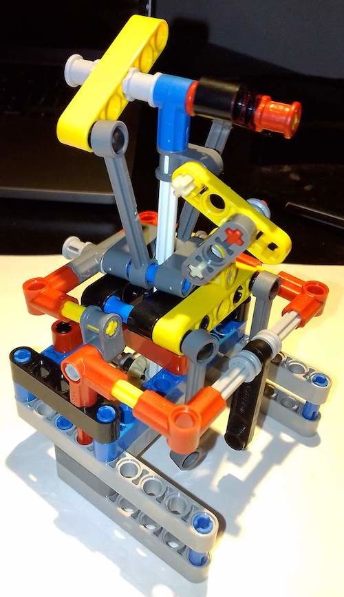

technicfanatic Posted March 12, 2022 Author Posted March 12, 2022 (edited) @Pattspatt still writing it all up, still have to clean up the stud.io file but here are two videos with the mechanism visible (taken before I mounted the blades, pitch links and scissor link) Top-side view: Side view: I will make a video with the complete assembly, but you all know that part already Here's a detail view of my pivot sleeve solution. I was inordinately gleeful to have solved the puzzle this way. Edited March 12, 2022 by technicfanatic Add image from github repo Quote
2GodBDGlory Posted March 13, 2022 Posted March 13, 2022 Very nice! I like seeing complex mechanisms like this one. What is the black ball part you're using in the middle of the swashplate? Quote
technicfanatic Posted March 13, 2022 Author Posted March 13, 2022 It's the LEGO Helicopter Pivot sleeve, mislabeled in the official catalog as 55889 Wheel 18 x 14 smooth. It was the product of one night of searching randomly through the catalog muttering "They have a million parts, surely one of them will work." Quote
2GodBDGlory Posted March 13, 2022 Posted March 13, 2022 On 3/13/2022 at 12:26 AM, technicfanatic said: It's the LEGO Helicopter Pivot sleeve, mislabeled in the official catalog as 55889 Wheel 18 x 14 smooth. It was the product of one night of searching randomly through the catalog muttering "They have a million parts, surely one of them will work." Expand Nice job finding that! I'll have to pick up one of those in case I ever build a helicopter. It looks super convenient, and I wonder if it'll be used in the official helicopter rumored for this summer! Quote

Pattspatt Posted March 15, 2022 Posted March 15, 2022 On 3/12/2022 at 11:24 PM, technicfanatic said: here are two videos with the mechanism visible (taken before I mounted the blades, pitch links and scissor link) Expand Wow, great work! Very cool to see it all exposed like that. Still takes a while for me to wrap my mind around it! Thanks for the demonstration - looking forward to seeing more independent collective motion too, assuming you plan to add a bit more friction to the cyclic’s joysticks. On 3/12/2022 at 11:24 PM, technicfanatic said: Here's a detail view of my pivot sleeve solution. Expand Genius part usage! I wonder, though - since the ball is not mounted in exactly the same plane as the turntable but one stud higher, will that cause jerky rotation once everything else attached? I’m having trouble figuring out whether that’s a problem just from a thought experiment - I do see that your towballs are in the same plane as the ball, which makes sense. Quote
technicfanatic Posted March 15, 2022 Author Posted March 15, 2022 (edited) On 3/15/2022 at 7:07 PM, Pattspatt said: Wow, great work! Very cool to see it all exposed like that. Still takes a while for me to wrap my mind around it! Thanks for the demonstration - looking forward to seeing more independent collective motion too, assuming you plan to add a bit more friction to the cyclic’s joysticks. Expand Heh, trust you to home in on key issues. This is exactly right - I will add some friction pins. I believe that there is no cross-talk between the two channels because the collective moves the center of rotation of the cyclic levers the same amount as it raises the pivot sleeve (as in the Bell 206), but you are correct in that I have to demonstrate this clearly. Quote Genius part usage! I wonder, though - since the ball is not mounted in exactly the same plane as the turntable but one stud higher, will that cause jerky rotation once everything else attached? I’m having trouble figuring out whether that’s a problem just from a thought experiment - I do see that your towballs are in the same plane as the ball, which makes sense. Expand Again, perceptive point! I made the center of movement the pin holes of the top disk. I did this to simplify the attachment point of the scissor link and the pitch links whose axes have to go through the center of rotation, otherwise unwanted lateral motions are introduced into what should be pure rotations. This is the reason the cyclic control links attach to the end of a bent piece which brings the attachment (almost) to the plane of rotation (it's actually 1/2 a pin hole off, but this is swallowed by the slop in the components, and this is anyway not so critical as it is for the scissor and pitch links which have to deal with rotation of the turntable as well as tilting.) What I missed even on this iteration is the fact that we are not done constraining the motion of the swashplate. If you look at the photo of the pivot sleeve above you will note a vertical cutout. This vertical guide is essential to prevent the swashplate from twisting, which is what happens currently. I don't have room for such a mechanism in my model of the pivot sleeve, but I can use the mechanism used in the Bell 407/412 which is an external scissor link that constrains the stationary swashplate from twisting. (The scissor link in question is on the left in this photo) Edited March 15, 2022 by technicfanatic Quote
Pattspatt Posted March 15, 2022 Posted March 15, 2022 On 3/15/2022 at 7:40 PM, technicfanatic said: I believe that there is no cross-talk between the two channels because the collective moves the center of rotation of the cyclic levers the same amount as it raises the pivot sleeve (as in the Bell 206) Expand Agreed, very nice geometry! It’s very cool to see a faithful representation in a more accessible format. On 3/15/2022 at 7:40 PM, technicfanatic said: I made the center of movement the pin holes of the top disk. I did this to simplify the attachment point of the scissor link and the pitch links whose axes have to go through the center of rotation, otherwise unwanted lateral motions are introduced into what should be pure rotations. Expand Makes sense - thanks for the explanation! On 3/15/2022 at 7:40 PM, technicfanatic said: I don't have room for such a mechanism in my model of the pivot sleeve, but I can use the mechanism used in the Bell 407/412 which is an external scissor link that constrains the stationary swashplate from twisting. Expand Nice, didn’t realize that a scissor link is also often used on the bottom half. The solution I used was restricting lateral movement of the links to the lower half. Cool to see two examples of the real-life solution! Quote
