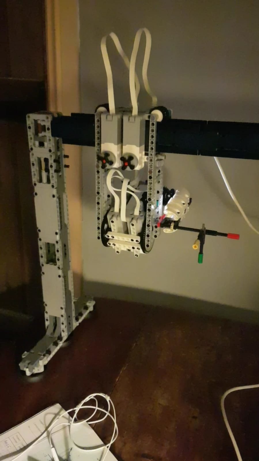

ord Posted December 5, 2021 Posted December 5, 2021 @dunes maybe this is stuck in a loop (motorC is never considered 'stalled'): while not motorC.control.stalled(): wait(1) Have you tried done() instead? while not motorC.control.done(): wait(1) As for wait=False being possible with run_until_stalled... I don't think it is. This is the workaround I use on my plotter project: motor_y1.run(50) motor_y2.run(50) wait(50) while motor_y1.speed() > 10 or motor_y2.speed() > 10: motor_y1.dc(30) motor_y2.dc(30) Quote
