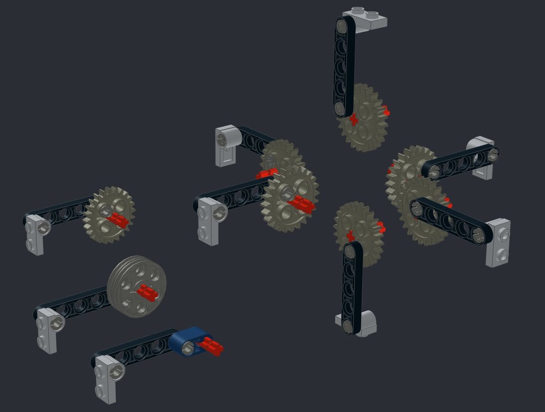

In the meantime one approach I'm looking into is having something like this: reciprocal motion but in 6 directions at the same time originating from a common center point.
Edited by Jdmnstr
Here is a very early idea for the interior. I will post some more pictures. none of the movement has to be in sync (actually even better if it is not), but i have no clue how to connect the respective parts inside a cube.
