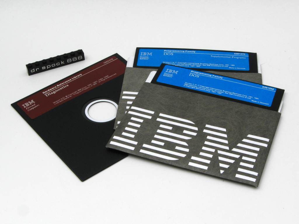

dr_spock Posted November 2, 2022 Posted November 2, 2022 I still have a copy of IBM DOS 3.10 copyrighted 1985. 128K RAM recommended. Back when a Bill dude said you didn't need more than 640K of RAM. I finally picked up that freebie SCOUT. It had issues with leaked alkaline batteries. I guess Duracells. Took apart to clean. Replaced the broken negative terminal with a spring Threw some Dyson power at it. It can run my PF motors with a PF extension cable. What else can it do? What software is used to program the SCOUT? I don't have a serial IR tower. Quote

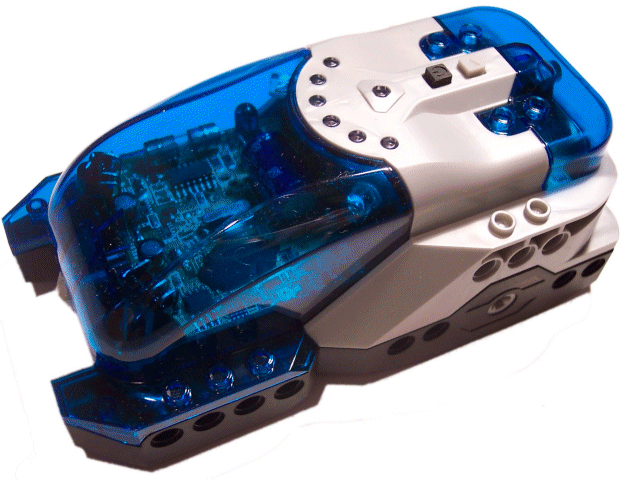

BrickTronic Posted November 14, 2022 Posted November 14, 2022 On 11/2/2022 at 5:10 AM, dr_spock said: ... ... Hello, Is it possinle to make closeup pictures from the Scout PCB Assembly Top & Bottom View ? Jo Quote

Toastie Posted November 16, 2022 Author Posted November 16, 2022 (edited) On 11/14/2022 at 6:41 PM, BrickTronic said: s it possinle to make closeup pictures from the Scout PCB Assembly Top & Bottom View ? Here's the bottom view of the PCB - nothing much to see - other than corrosion :D Did the same thing as @dr_spock, but had enough non-corroded copper on the top side to solder connections there so that I could still use the metal strips (after heavy treatment) and thus batteries: Best, Thorsten Edited November 16, 2022 by Toastie Quote

BrickTronic Posted November 18, 2022 Posted November 18, 2022 On 11/16/2022 at 8:24 PM, Toastie said: ... Hello Many Thanks to @Toastie and @dr_spock' Big surprice, that uC seems to be placed under the LCD Jo Quote
Toastie Posted November 18, 2022 Author Posted November 18, 2022 Hello Jo, now, if it is important to you, I can remove the LCD from a "broken" SCOUT and take a shot. You probably know this website as well: https://brickipedia.fandom.com/wiki/Mindstorms_RCX#Scout At least we learn it is a Motorola microcontroller with so-and-so much RAM/ROM. Just let me know. Best, Thorsten Quote
BrickTronic Posted November 18, 2022 Posted November 18, 2022 5 hours ago, Toastie said: Hello Jo, now, if it is important to you, I can remove the LCD from a "broken" SCOUT and take a shot. You probably know this website as well: https://brickipedia.fandom.com/wiki/Mindstorms_RCX#Scout At least we learn it is a Motorola microcontroller with so-and-so much RAM/ROM. Just let me know. Best, Thorsten Hello Toastie, Thaks for your proposal, I'll be happy to get more Details here. The Bricjpedia-Page mentiones a Toshiba uC with 32k (Mask-) ROM and 1K RAM Would be nice to figure out what Processor exactly and maybe to find its Data-Sheet I'm asking myself, if there is also an LCD Controller used like in the RCX Jo Quote

Toastie Posted November 20, 2022 Author Posted November 20, 2022 Hi @BrickTronic, On 11/18/2022 at 8:14 PM, BrickTronic said: I'll be happy to get more Details here. Here you go: and even closer: This document (PDF) may be a matching datasheet - it is from Toshiba, from 1999, it covers 8-bit microcontrollers, and it has an onboard LCD driver. But who knows, TLG is always making big secrets about their electronic chippies: https://brickshelf.com/gallery/ThorstenB/ThisAndThat/SCOUT/tmp86cm29u.txt (You need to rename the .txt extension to .pdf - Brickshelf does not like PDFs to be uploaded). Best regards, Thorsten Quote

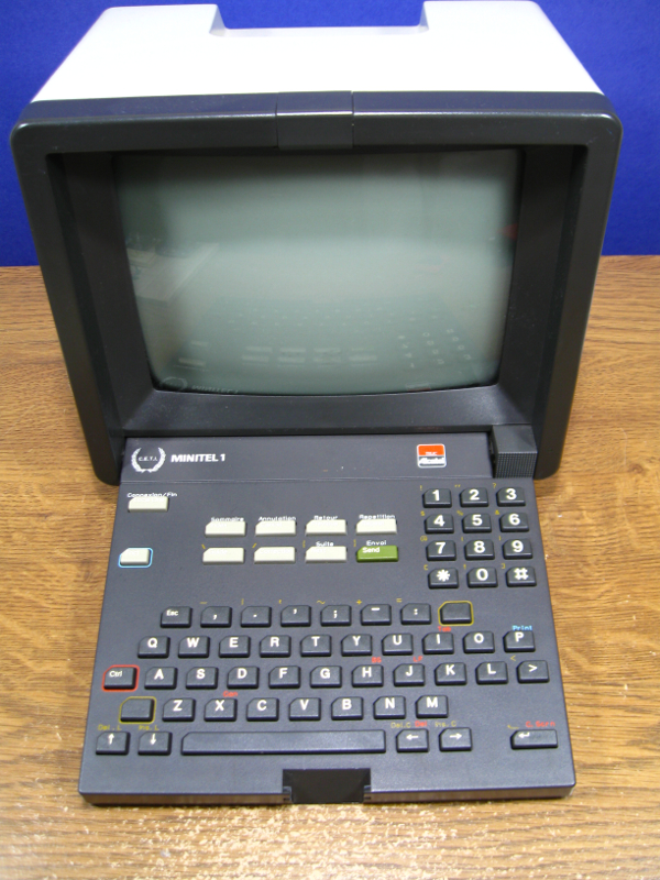

dr_spock Posted November 22, 2022 Posted November 22, 2022 Good questions. I guess mimic RS232 IR LEGO Tower. I have a RS232 port on my old Thinkpad. I ran ScoutTool.exe in Windows 98. It's looking for ghosts? I received an order of MAX232 chips today. Going to turn an old Minitel into a serial TTY terminal for the 3D printer. They might be useful for a RS232 tower too? All this old hardware is a slippery slope, eh? Thanks. Quote
Toastie Posted November 22, 2022 Author Posted November 22, 2022 (edited) On 11/22/2022 at 5:16 AM, dr_spock said: I ran ScoutTool.exe in Windows 98. It's looking for ghosts? Oh yes - TLG and names ... very camouflage they always are ... This is from the Scout tool help PDF: Note: The Scout Tool includes an alpha version of LEGO's new communications driver called "Ghost" (which will replace "Spirit.OCX" for products released in the future) BTW, there were never any updates of that alpha version within the Scout SDK - software development sucks :D. Well, the alpha version works fine. However, the Mindstorms SDK 2.5 (this is a really nice package!!!) has all the documentation needed to use the GhostAPI (data transport protocol, good for the C/C++ hardcore programmers almost hacking the PCB :D) and the IVPBrick COM interface (for slackers like me, who use VB6 and the like ...). Yes, there was a time, back then, when Y2K appeared to be a deadly threat, and TLG produced detailed and very nice to read documentation of their software products! But back to your RS232 tower: In this case (mimic the tower), the UNO is a bit overkill, but will work of course!!! It would also come in very handy, if you e.g. wanted to tap into the data stream from/to the computer to the PBrick or generate byte codes, wrap them into the IR protocol and send them/listen to a PBrick. As the UNO runs on 5V; you would need a MAX232 or the like anyway. All the UNO would then do is generating the 38KHz modulation of the IR LED light, preferentially using one of its timers, so it does not suck up any memory: // Program 38kHzOutput (fixed pin 11) // Code copied from: // https://forum.arduino.cc/index.php?topic=102430.0 // How to create a 38 Khz pulse with arduino using timer or PWM? // Used here with no changes on an Uno R3 clone void setup() { pinMode (10, OUTPUT); // Just to switch IR LED ON/OFF; used for RS232 data stream pinMode (11, OUTPUT); // Pin 11: Timer 2 "A" output: OC2A // set up Timer 2 TCCR2A = _BV (COM2A0) | _BV(WGM21); // CTC, toggle OC2A on Compare Match TCCR2B = _BV (CS20); // No prescaler OCR2A = 208; // Original value: 209. // Original comment: "compare A register value (210 * clock speed) // = 13.125 nS , so frequency is 1 / (2 * 13.125) = 38095" // This results in 37.83 kHz on the Uno R3 clone board // Changed to 208 - this results in 38.01 kHz } // end of setup void loop() { //digitalWrite(10, HIGH); digitalWrite(10, !digitalRead(10));// toggle; LED cathode is connected to pin 10 delay(1000); // wait 1s // LED anode is connected to pin 11 via a 220Ohm resitor } As you have ordered the MAX232's this will work for sure - and the nice thing is you have the UNO as power supply! The serial tower is as dumb as it gets :D. Here is the schematic, I copied from this website (there are others as well, but they are not entirely correct):https://robotika.sk/maine.php, but I can't find the drawing on that site anymore, did copy it last year or so: Here is a thread on EB, which shows a non-UNO approach (the UNO replaces everything in the above schematic but the IR LED(s) + resistors + TSOP): Just see the OP entry, as you don't want to go wireless. Most importantly: When using TLG software (Scout Tool etc.) make sure that the bridge 7-8 (RTS-CTS) is present. The software probes that line. Let me know if you need anything else. BTW: All the LEGO software runs fine on Win11/64bit with a USB/serial converter. The latter just needs to be on one of the first 8 COM ports, as no one thought back then there will be more than 8 COM ports on any computer to come in the future :D) Best, Thorsten Edited November 23, 2022 by Toastie Quote
Toastie Posted November 22, 2022 Author Posted November 22, 2022 5 hours ago, dr_spock said: an old Minitel What a beauty!!! Just read the Wikipedia article about Minitel/Télétel - I had never heard of this before, thank you! From that article: "It downlinked at 1200 bit/s (9 KB/min) and uplinked at 75 bit/s (0.6 KB/min). This allowed fast downloads, for the time." It is always good to recalibrate from time to time ... fast downloads :D How come that you have a "QWERTY" layout on your Minitel? This is a very nice project! A Minitel telling a 3D printer what to do ... I wonder what people would have said back then to 3D printing Oh yes, it is a very slippery slope. And fun to ride it! Best, Thorsten Quote
dr_spock Posted November 23, 2022 Posted November 23, 2022 16 hours ago, Toastie said: Oh yes - TLG and names ... very camouflage they always are ... This is from the Scout tool help PDF: .... Thank you very much for the snippet of code and links. The RTS-CTS is good to know. 14 hours ago, Toastie said: What a beauty!!! Just read the Wikipedia article about Minitel/Télétel - I had never heard of this before, thank you! How come that you have a "QWERTY" layout on your Minitel? ... I have a "North America" version of the Minitel. The keyboard feels pretty chiclet-key. It was used in a Bell Canada service called ALEX. It has a DIN 6 RS232 port in the back. I think it could be used as a serial monitor for the Arduino boards too. Maybe display messages from a Mindstorms EV3 with a bluetooth to RS232 interface? Quote
