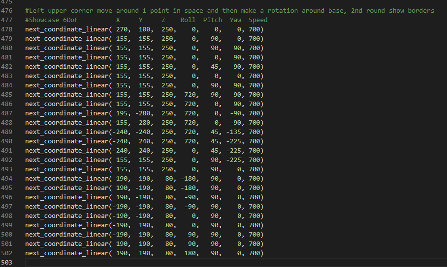

ninoguba Posted November 9, 2020 Posted November 9, 2020 (edited) Hello, First topic post here. =) So I've built a 6DoF robot arm with a motorized end effector and have so far only done the basic programming of the joint movements using python (ev3dev). I have looked at implementations of reverse kinematics and RRT path planning on other robot platforms and would like to implement it for my arm. Anyone on here has done it before and would like to share how they've done it? Looking for collaborators on the programming side if there is any interest. Here's the link to my very basic code so far: https://github.com/ninoguba/ev3-robotic-arm Thanks, Nino Edited November 10, 2020 by ninoguba Quote

ninoguba Posted January 4, 2021 Author Posted January 4, 2021 (edited) Glad you found the thread and I'm looking forward to your updates as well. Would you be interested in collaborating on the programming? I envision something that can be adapted to any model of LEGO EV3 robot arms, perhaps by parameterizing the number of joints, dimensions, etc. and the type of end-effectors used. If you don't mind sharing your code on Github, I'm interested to compare it with what I have already. Something I haven't shared publicly before is what got me started with making my robot arm. A year or so ago, I had an idea I wanted to do for an entry to the LEGO Mindstorms + Alexa Contest to combine my fondness for LEGO, Nerf and Alexa. That idea was a robotic arm that has a target for Nerf blasters on its end-effector. The movement of the target will be randomized so that it's quite a challenge for target practice kinda like skeet shooting. Alexa will be used for the voice commands and sound effects. That idea proved hard to complete due to the limited time to meet the contest deadline so I've pivoted to a simpler entry for the contest here - https://www.hackster.io/nino-guba/lego-target-practice-powered-by-mindstorms-ev3-and-alexa-fd1af8. Then at the beginning of the year and due to the pandemic quarantine, I had the chance to get back to working on my robotic arm again. Initially planned to attach the ultrasonic sensor at the end-effector to track when a Nerf Rival round passed through the target. Also thought of having a touch sensor being activated when a physical target on the end-effector is hit. Went through several iterations of the arm, starting from 3 degrees of freedom, to 4, to 5, then eventually to 6 thanks to Akiyuki's wrist design for inspiration. At each iteration, I also was able to improve the range of motion and strength of the most critical joints - shoulder and elbow. Then lastly, I was able to add motorization of the end-effector using another medium EV3 motor. Most I've seen, like yours, used pneumatics at the end-effector which I don't have. My robot arm at its current form, models industrial robot arms such as the Kuka Agilus. I think it's cool that I was able to build such a moc! At some point, I still would like complete my original application for the project but this would really require finishing the implementation of inverse kinematics algorithm which is also making my head spin. =) Good luck to us in completing our projects! Anybody else working on their 6DoF robot arms are welcome to post their progress here. Edited January 4, 2021 by ninoguba Quote

ninoguba Posted January 7, 2021 Author Posted January 7, 2021 Glad to know of fellow 6DoF arm builders ! I've actually stumbled on the concept of "Gradient Descent" for implementing inverse kinematics. But same as before, it is still making my head spin trying to understand and implement it in my code. Here's the link, in case, it helps you on your projects too. https://www.marginallyclever.com/2020/04/gradient-descent-inverse-kinematics-for-6dof-robot-arms/ On 1/4/2021 at 9:45 PM, Tomphase3 said: Ninogubu: Thank you for your detailed message. I appreciate not being alone in this. I've just posted the code to Github. https://github.com/tomwilsonmn/LEGO-EV3-n-DOF-Manipulator Please feel free to critique it, freely borrow from it, and see if there is a way we can collaborate. ... Tom Expand Thanks for sharing you code! I'll take a look one of these days... Quote

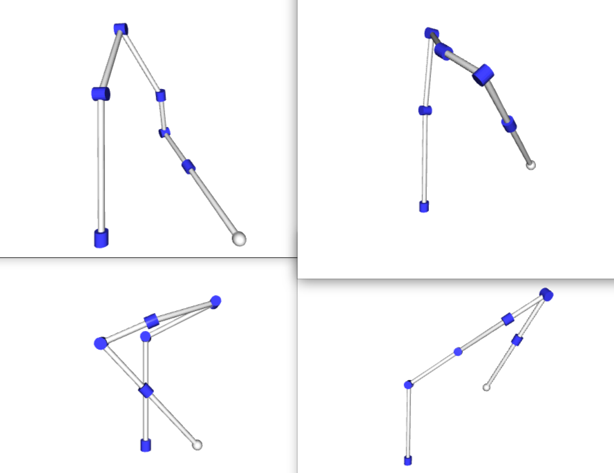

Mr Jos Posted January 30, 2021 Posted January 30, 2021 (edited) On 11/10/2020 at 1:47 PM, ord said: Nice robot arm! I'm working on one myself so will be following this thread. I haven't done it before but was considering using the Robotics toolbox for Matlab to simulate the arm and get joint coordinates to plug into python. Any idea how you might approach it? Expand On 11/20/2020 at 4:44 PM, m3eu said: There is little to no information about the programming code used. Akiyuki posted he programmed in C using TOPPERS/EV3RT. Don't have much experience in this field myself, maybe it helps. Expand On 1/3/2021 at 7:44 PM, Tomphase3 said: Delighted to have found this thread. I, too, am building a 6-axis robot plus pneumatic end-effector, with plans to employ a reverse kinematics algorithm to calculate the angle joints (thetas) when supplied with coordinates and orientation of the end effector. Eventually I plan to add machine vision so the robot can locate and pick up an object and place it in a pile, based on the object's characteristics. ... I was also inspired by Akiyuki's excellent wrist design, but have made the joint mechanisms stronger than his design to avoid gear slippage. The robot automatically calibrates each joint by jamming the joint. I sacrificed a bit of smooth motion for robustness, and may return to that issue another time. Of course I welcome feedback, and look forward to ninoguba's updates. Expand On 1/5/2021 at 8:08 PM, Amicus1 said: Hopping on the train because these arms seem to be a common thing to do. I’ve found that for my purposes I can probably work in one section of cylindrical coordinates. The base turntable and everything up to the wrist provides a position in a cylinder (a 2d plane rotated around the turntable) and the wrist is a quaternion in Cartesian. I haven’t actually tried it though. Expand On 1/7/2021 at 8:59 PM, ninoguba said: Glad to know of fellow 6DoF arm builders ! I've actually stumbled on the concept of "Gradient Descent" for implementing inverse kinematics. But same as before, it is still making my head spin trying to understand and implement it in my code. Here's the link, in case, it helps you on your projects too. https://www.marginallyclever.com/2020/04/gradient-descent-inverse-kinematics-for-6dof-robot-arms/ Thanks for sharing you code! I'll take a look one of these days... Expand @all of you: Wanted to let you know that it is possible with Micropython/Pybricks to perform Inverse Kinematics on the 6DoF!! Just finished being able to do all kinds of positioning, but it's not 100% finished yet, need to clean up my code a lot and build in some limits (now only theta2/3/5 are limited, but it can still crash into itselve. if Yaw >120° and XYZ gets to close to the robot. This is what I used for this video. Now I want to find out if and how I can use a bluetooth controller together with the 6DoF. I think like Playstation or something? I don't have any consoles. But what I want to do is move X/Y with joystick whilst maintaining Z altitude, that gets controlled by other buttons. 2nd joystick for Yaw/Pitch and buttons for Roll. Then use a button to save positions (with the forward kinematics), and then let the program run. But not tracking exactly what was done with remote, but using a linear path with IK. So it will be easy to make animations, and fun I guess? Without having to hardcode these positions like in the screenshot. Edited January 30, 2021 by Mr Jos Added screenshot with positions. Quote
Tomphase3 Posted February 10, 2021 Posted February 10, 2021 My 6 DOF manipulator has been sitting on a shelf for a few weeks, waiting for more programming. I've decided to pause programming until I have a better handle on inverse kinematics. The other day I came across this: https://github.com/lanius/tinyik "tinyik is a simple and naive inverse kinematics solver." At this point this library and I are a good match, "simple" and "naive." I put together a short program using tinyik, plugging in parameters from my manipulator, and produced these simulations: These simulations are a pretty good representation of my manipulator. For each simulation, all I changed in the code were the coordinates of the end effector. For example, here's the code for the top-left simulation. import tinyik import numpy as np import open3d as o3d body =tinyik.Actuator(['y',[0, 2.1, .0],'z', [1.5, .0, .0], 'z', [1.3, .0, .6], 'x', [.9, .0, .0], 'z', [1.1, .0, .0],'x', [1.5, .0, .0]]) # 1.0 = 10 LEGO studs body.ee = [2.,0, 0] # position of End Effector tinyik.visualize(body) I need to look at this more closely, but it does look pretty reasonable. Going through the library code, I can see the inverse kinematics solver is iterative/analytical/converging on a solution, as you would expect. Beyond that, I can't yet vouch for the efficacy of the code. However it's promising, and most appealing to my laziness. All I have to do is plug in the coordinates of the end effector, and I get the thetas (angles) for all the joints. For now, I'm not concerned about the orientation of the end effector. At a minimum, this is raising my comfort level. Quote
