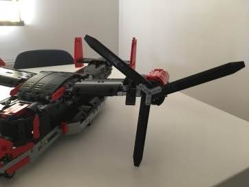

I currently have a blade-less Osprey, anyone got any ideas? I have tried part 62743 (2 x 16 rotor blade), I was able to adapt the mount perfectly but they were too long! Other than this I have all the other problems solved.

The new rotor blades are 19 long so the 16 long cannot be too long. You can use 3x 62743 in combination with 32125 or 44374 and 2L axles.

Hmmm... that is very interesting then as I thought these blades were shorter too but I have collision issues with the floor with these blades. I am guessing that it is not designed to fly in this way so in the real world this isn't an issue?

It's not a bug, it's a feature. Yes, the blades cannot spin with horizontal engines at take-off and the LEGO ones are actually shorter than on the real aircraft. Max angle is about 45° for ground clearance.
Thanks for the help guys, I have actually managed to modify the existing mount to fit the smaller blades so that I can get the slight angle on them. I have tried to upload a picture but I think I have hit a limit as I don't often comment on here, I am more of a lurker.
Basically I just replaced the 32148 elements (Technic Axle and Pin Connector 3L w/ Center Pin) with 32449 (Liftarm 1 x 4 Thin). Then I could reconfigure the attachment points for these blades instead of the official ones.
