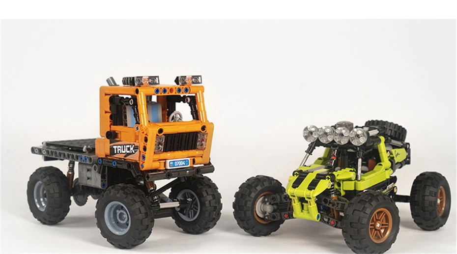

agrof Posted March 15, 2020 Posted March 15, 2020 (edited) After long pause, I sat down today to play around with LDD. Oddly the inspiration came from here - see below. Spoiler Xingbao 07007 - on the right. Unfortunately I can not find any instructions for them, but based on reviews, it is not a very rigid construction. This will be a concept UTV for King Of Hammers, first design is ready, I need to build IRL and test. Considering the Corona situation, it might remain digital for a while though, as I might not have all the necessary parts on stock. 323 pcs so far. Nothing special in terms of functions: suspension, HOG steering, differential with fake engine (easy pop-on/off), fake automatic transmission. The latter is just sume pulley wheels and gears rotating along with the cranckshaft, round and bulky, just like a real hydraulic one. In real model, I will fit the tire on the inner wedges of the rim, thus it will get a bit higher (~58 mm) but narrower (~22 mm) profile. Edited April 8, 2020 by agrof Updated picture. Seemingly people avoid to comment here, so this new name suits well in these challenging times. Quote

agrof Posted March 20, 2020 Author Posted March 20, 2020 (edited) Some details improved, some parts changed for more common ones - I think all changes are benefitial. The best part is, that the clutch is no more a dummy, it has actual function to bridge the 1/2 stud axle offset for the engine cranks, and to provide the rotation. I updated the LXF file too (attention not tested yet IRL, so updates might come), in more accessible red color, can be find HERE. EDIT: obsolete, removed link. It has groups, in backwards building sequence, 380 pcs. Personally, I stick to the lime version, with some viral parts, migrated from CADA set - like black shock absorbers, etc. Edited March 31, 2020 by agrof Quote

agrof Posted March 22, 2020 Author Posted March 22, 2020 Sitting home, playing around with renders - I made a cover picture in the first post, hope You like it. Quote
agrof Posted March 25, 2020 Author Posted March 25, 2020 (edited) I have built it, made the necessary changes. The rear suspension is still a tad hard, but acceptable, also proper placement of the clutch is very important, so the pins don't get stuck on the bracket parts. It is on REBRICKABLE, also the final LDD file is available (in RED). I just got the subconscious message, UTV refers here: Undo The Virus... Edited March 31, 2020 by agrof changed photos Quote

agrof Posted March 27, 2020 Author Posted March 27, 2020 (edited) UPDATE - I made some minor tweaks in the design, also took some nicer photos (see above). The model is available in Stud.io too: CLICK HERE to download. Both the LDD file and Rebrickable are refreshed. Edited March 29, 2020 by agrof LDD file removed Quote

agrof Posted April 8, 2020 Author Posted April 8, 2020 Update: the harder rear suspension bugged me, but there was too much sideways slack with the softer setup. Finally I found an easy way to keep the twist of the rear axle within acceptable limits. Here is a small patch, which provides much more satisfying suspension experience, of course to be done on both sides. Also it utilises the spring travel perfectly. Quote
