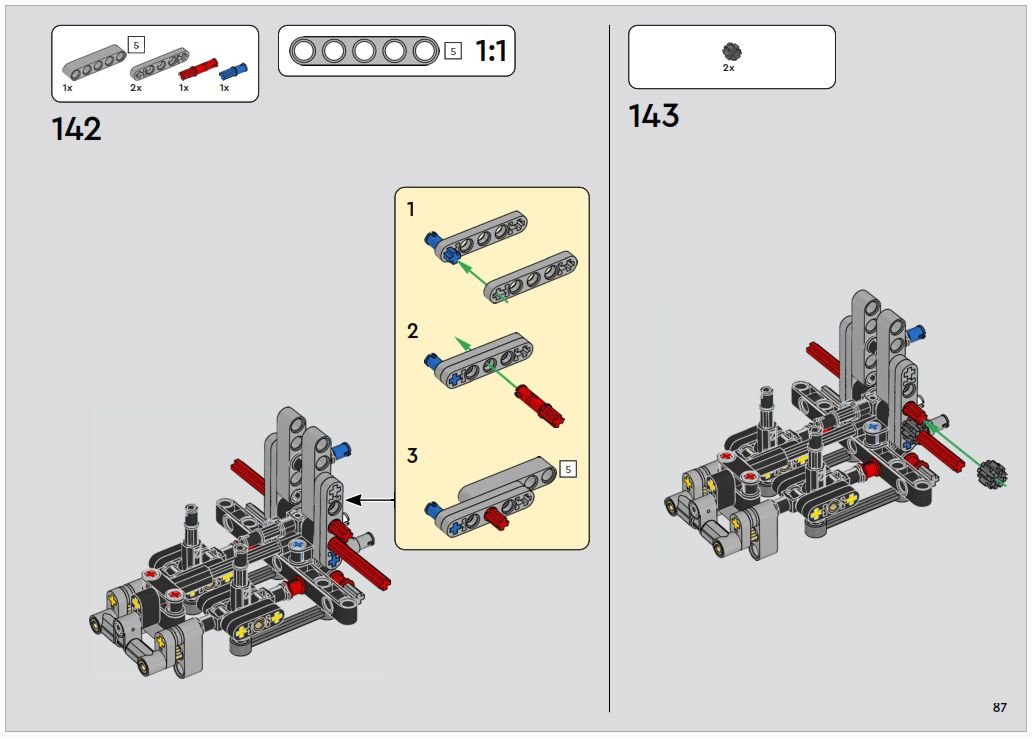

SJMarty Posted January 21, 2023 Posted January 21, 2023 Hello, I'm building the 42145 Airbus H175 Rescue Helicopter. On step 142, the instructions show inserting a red pin with axle through two narrow beams, through a wide beam, and in step 143, placing a pinion on the axle end and another pinion on the axle beneath it. After installing both pinions, the longer axle is almost impossible to turn due to the friction from the red pin with the axle end holding the pinion above it. Before continuing, I want to make sure this is correct as it doesn't seem right. Thank you! Quote
2GodBDGlory Posted January 21, 2023 Posted January 21, 2023 On 1/21/2023 at 4:40 PM, SJMarty said: Hello, I'm building the 42145 Airbus H175 Rescue Helicopter. On step 142, the instructions show inserting a red pin with axle through two narrow beams, through a wide beam, and in step 143, placing a pinion on the axle end and another pinion on the axle beneath it. After installing both pinions, the longer axle is almost impossible to turn due to the friction from the red pin with the axle end holding the pinion above it. Before continuing, I want to make sure this is correct as it doesn't seem right. Thank you! Expand Welcome to Eurobricks! I'm pretty sure that should be fine. It might be hard to rotate that long red axle right now by grabbing the axle, but if you pull on the center lever (or the other one that isn't installed at this point in the build) you should have significantly more leverage to get it moving. That's a great set you're working on! Quote
SJMarty Posted January 21, 2023 Posted January 21, 2023 On 1/21/2023 at 5:10 PM, 2GodBDGlory said: Welcome to Eurobricks! I'm pretty sure that should be fine. It might be hard to rotate that long red axle right now by grabbing the axle, but if you pull on the center lever (or the other one that isn't installed at this point in the build) you should have significantly more leverage to get it moving. That's a great set you're working on! Expand Thanks for the quick reply. I pushed a few steps further and I'll tell you, it still doesn't seem right. I recently purchased the 9396 set and ironically ran into this same type of issue with the winch. The instructions called for a friction pin with a stop bushing on one end. This configuration prevented the reel from turning. I ended up replacing the friction pin with an axle and this resolved that issue. I found this posting (after-the-fact) that called for the same solution. My hesitancy to proceed is if something similar has to be done with the Airbus, I'm afraid the whole assembly is going to have to be torn down. Quote
vascolp Posted January 21, 2023 Posted January 21, 2023 Don´t hesitate ! The friction pin is there exactly to avoid the mechanism to be too loose. Otherwise the weight of the mecanism would make it return to the lower position. Chek it in this video, for instance. Compared with 9396 winch, this is way more complex... one of the things that makes this set amazing! Have a nice build! Quote
SJMarty Posted January 22, 2023 Posted January 22, 2023 Thanks for the help and link. Pressing on! Quote
anyUser Posted January 22, 2023 Posted January 22, 2023 On 1/21/2023 at 4:40 PM, SJMarty said: After installing both pinions, the longer axle is almost impossible to turn due to the friction from the red pin with the axle end holding the pinion above it. Expand Hello, I had the same impression and wrote about is some time ago. There were a few remarks on that. Quote
