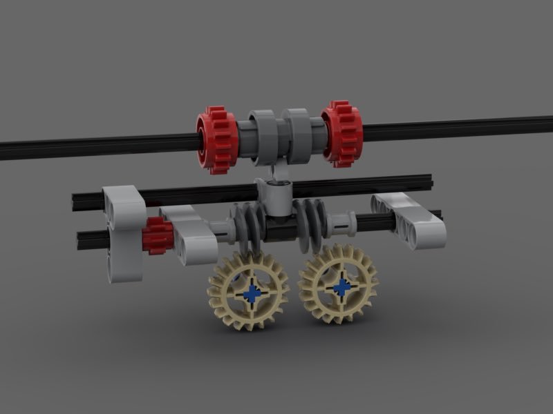

npicard Posted August 15, 2021 Posted August 15, 2021 Hi all, I'm trying to make a motorized gearbox – this is nothing new, but I have a special constraint. Due to the rest of the model, the motor changing the gears can't turn on and off. Continuous forward should change the drive shaft into first gear, continuous backwards should change into second gear. Here is my current solution. Select gears by rotating the red 8-tooth gear clockwise or counterclockwise. Both bottom axles slide left and right together along with the catch that interacts with the driving ring. There are a couple of problems with this build. The main issue is that I want to use the output from one or both tan gears (currently just held on with friction pins). They are turning at 1/20 the input speed, which is a really awful ratio. Also, if there is a way to get the whole thing smaller, lower friction, or both, that would be great. I don't think any of the above can be accomplished without a totally new mechanism – I think this one is pretty close to optimized (it's about a month of work and help from Reddit user u/Daap72). Any ideas for a novel mechanism would be greatly appreciated! Improvements to this one are also welcome. Thanks in advance for your help. Quote
Keegan Pilling Posted August 15, 2021 Posted August 15, 2021 Would something like this fit the constraints of your build? Just replace the pneumatic valve with a red shift lever (or linkage to connect to one) Also, if you don’t have your worm gear offset by half a stud, you can replace the two pinions with 8 tooth gears, saves a lot of space and works better with Technic’s odd lengths. Credit goes to Sariel http://sariel.pl/2008/12/pneumatic-autovalve/ Quote
npicard Posted August 15, 2021 Posted August 15, 2021 On 8/15/2021 at 9:20 PM, Keegan Pilling said: Would something like this fit the constraints of your build? Just replace the pneumatic valve with a red shift lever (or linkage to connect to one) Also, if you don’t have your worm gear offset by half a stud, you can replace the two pinions with 8 tooth gears, saves a lot of space and works better with Technic’s odd lengths. Credit goes to Sariel http://sariel.pl/2008/12/pneumatic-autovalve/ Expand That would likely save space, yes! Thanks for your input. Unfortunately, it doesn't solve the issue of the slow output speed. I currently need to gear up the output from the tan gears from 1:20 back up to 1:1. The 20:1 gear-up requires 6 gears to accomplish. The solution you linked to would need either a 12:1 gear-up or 8:1 gear-up. Both of these also require a 6-gear train to achieve. As I said, it's significantly more compact though, if I can figure out how to get the rotating liftarms to engage correctly with the red shift lever. Shouldn't be too hard. Thank you again! Quote
Keegan Pilling Posted August 16, 2021 Posted August 16, 2021 Does the output from the two gears have to be in that position? If not, you could just put a 90 degree gearbox (two 12t bevels) on the end of the axle driving the worm gear. Even if you need that output directly below the gearbox, couldn’t you just drop down the drive from the worm gear input with two or three 16t or 24t gears, and then have a 90 degree gearbox there? Quote
npicard Posted August 16, 2021 Posted August 16, 2021 On 8/16/2021 at 12:17 AM, Keegan Pilling said: Does the output from the two gears have to be in that position? If not, you could just put a 90 degree gearbox (two 12t bevels) on the end of the axle driving the worm gear. Even if you need that output directly below the gearbox, couldn’t you just drop down the drive from the worm gear input with two or three 16t or 24t gears, and then have a 90 degree gearbox there? Expand The position of the output doesn't matter so much, but I need the current functionality that if the worm input is going one way, one of the tan gears rotates, and if it's going the other way, the other tan gear rotates. If I just took the input and outputted it straightforwardly, it would always be rotating in one direction or the other. Quote
Keegan Pilling Posted August 17, 2021 Posted August 17, 2021 On 8/16/2021 at 4:06 PM, npicard said: The position of the output doesn't matter so much, but I need the current functionality that if the worm input is going one way, one of the tan gears rotates, and if it's going the other way, the other tan gear rotates. If I just took the input and outputted it straightforwardly, it would always be rotating in one direction or the other. Expand What about one of these setups? If you want a 1:1 ratio without having to offset the red and yellow axles by 1/2 a stud, you will have to add a bar underneath the 2L liftarm, as done with the light blue mount in the second version. https://bricksafe.com/files/Keegan_Pilling/designs/E16C9D06-B5DA-42ED-9367-5FA000851DAF.jpeg Quote
