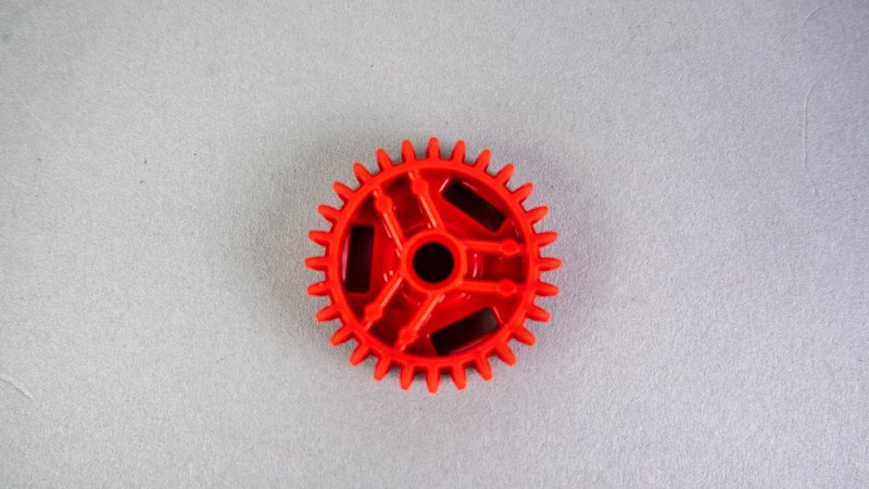

kbalage Posted December 28, 2019 Posted December 28, 2019 I took the new differential from the 42109 App-Controlled Top Gear Rally Car and compared it to the previous generations, also tried to see if there are any changes/improvements/benefits: Quote
nerdsforprez Posted December 28, 2019 Posted December 28, 2019 Interesting..... Looks based on what you covered the new one might have several advantages over the old.... Quote

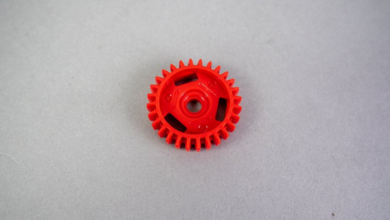

efferman Posted December 28, 2019 Posted December 28, 2019 Thanks for the Vid. Is it possible to flip the 28Z gear to make the Diff 3.5 wide? Quote
kbalage Posted December 28, 2019 Author Posted December 28, 2019 @efferman it is not possible, the other side is different and you cannot connect the clips: Quote
