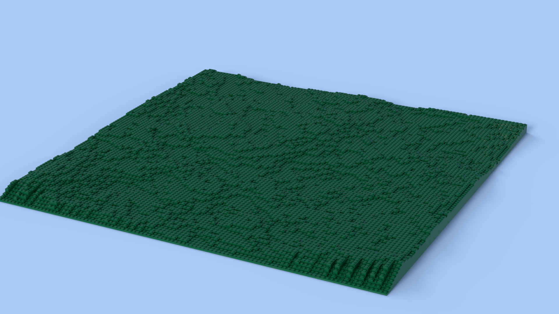

SylvainLS Posted April 10, 2020 Posted April 10, 2020 A little update on my cliff generator. Impelled by a discussion with supertruper1988, I changed the way the grass (or little bumps) on top of the cliff works. I simplified the algorithm and it now has fewer artefacts. When the top is flat (no height variation), it uses all sizes of plates (up to 16x16). That greatly reduces the number of parts. You can set the max height. This allows you to generate a slightly bumpy landscape (that was supertruper1988’s first goal): set the width (e.g. 100), set the height to 0, uncheck all the checkboxes, set the back line to the depth you want (e.g. 100), change the grass variation if you wish (e.g. 10), generate and save. Download is here. Quote
supertruper1988 Posted April 11, 2020 Posted April 11, 2020 The reduction of parts is very nice! I was doing some testing and accidentally generated a file with 170,000+ parts. 168,000 or so of those were 1x1 green plates Quote
