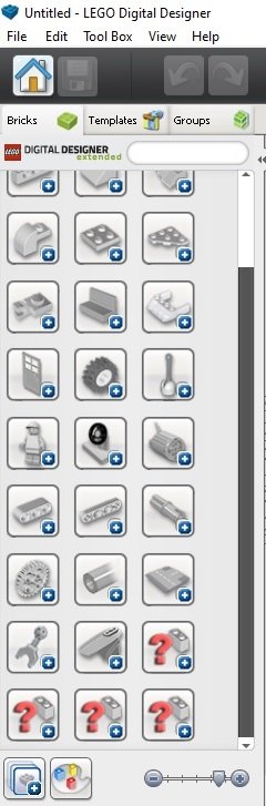

SteelRiftGaming Posted September 3, 2020 Posted September 3, 2020 hi im in extended mode and this is my menu it wasnt like this on my old laptop and the minifig parts and accessories werent all in one folder in the app Quote
Stephan Posted September 3, 2020 Posted September 3, 2020 (edited) It look like you have downloaded version .12. That's a "bugged" version. A few posts back, the link to the .11 version is written. LINK Edited September 3, 2020 by Stephan Quote
zweifuss Posted September 3, 2020 Posted September 3, 2020 (edited) On 9/3/2020 at 8:25 AM, Equilibrium said: @zweifuss Looks very nice, I'll dig out my UFO pieces and check how it compares :) But I have to say this - there's still room for improvement modeling-wise since your bricks requre some more work :P There are some gaps in geometry, overlaping faces, unsmoothed surfaces. I'll try to write short tutorial on how to get nice outlines in certain situations. Also, I have figured a trick on how to generate outlines on low angle surfaces (UFO dishes for example). Expand Any help is appreciated, I'm still a student when it comes to 3D modeling, but I am an eager learner, look forward to seeing a tutorial! The rim on the left, I know I forgot to apply 'smooth surfaces' for that one, I should repost a newer model, but as for the gaps and the lines not generating on low-angle surfaces, that I would appreciate insight on. I think for that saucer piece, I must have moved the UV-surface up just a titch by accident, so that is why the gap is in that one. But I'm not sure why that second rim piece has the gaps, I must have not imported it correctly from .DAT file... Edited September 3, 2020 by zweifuss Quote
SteelRiftGaming Posted September 4, 2020 Posted September 4, 2020 On 9/3/2020 at 11:49 AM, Stephan said: It look like you have downloaded version .12. That's a "bugged" version. A few posts back, the link to the .11 version is written. LINK Expand hi ive tried downloading that and when opening it nothing changes i was wondering if anyone could put their version of ldd and the ldd program files into a zip folder for download Quote
SylvainLS Posted September 4, 2020 Posted September 4, 2020 On 9/4/2020 at 8:37 PM, SteelRiftGaming said: hi ive tried downloading that and when opening it nothing changes i was wondering if anyone could put their version of ldd and the ldd program files into a zip folder for download Expand You need to deinstall the rotten version first and clean your user directory. Quote
