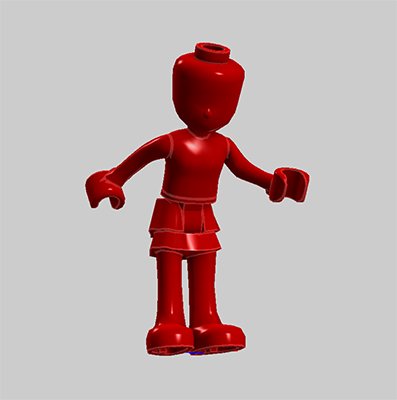

ProfessorBrickkeeper Posted August 2, 2020 Posted August 2, 2020 I've spent the past few evenings adding support for the mini-doll figure to LEGO Digital Designer. In the process, I've been tinkering around with the LDD connection system, and there seem to be a number of unused connections that are still recognized by the program. In case anyone finds them useful, where mini-dolls are concerned: Hinge 220 (F) /221 (M) are used for articulated connection between legs/hips. Hinge 222 (M) /223 (F) are is used for the articulated connection between arms/torso. Fixed 116 (F) /117 (M) are used for the fixed connection between hips/torso. Quote
