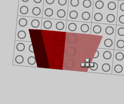

Download was successful from GitHub but part 30571 (the large raised baseplate) was not included in that version, and the LXF file of new parts could not load it.
Additionally, parts 48165 Wedge 3x3 Sloped Right and 42862 Wedge 3x3 Sloped Left have a boundary problem where other pieces cannot be placed against the flat edges.
Edited by PicnicBasketSam
added more information after downloading
