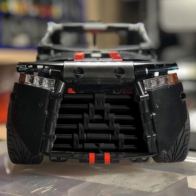

rm8 Posted September 17, 2019 Posted September 17, 2019 Very good. I think I also need higher roof. 16 hours ago, Zerobricks said: Looking very modern, rm8, especially with those lights. Thank you Jerry, join us Quote

johnnym Posted September 19, 2019 Posted September 19, 2019 @rm8 You already wrote it on YouTube and yes, "Lexus" was the first thing that came to my mind, when I saw that uber-grill. Very massive. Have you already tried it in black on black? I.e. like this mockup: I think that would "remove" a lot of its massiveness and look cooler IMO. Hey, maybe the 2L half beams in chrome silver as a highlight? And why does the front look so narrow? Is this the effect of the huge grill? I like how you incorporated all those angles - I still find it hard to do anything non-standard in my mods/MOCs. **** On 9/17/2019 at 3:11 PM, Thirdwigg said: My design is a little more evolutionary rather than revolutionary. It really looks different from this angle compared to the first shot - I mean the roof height and doors.. I hope you'll provide a digital version of the truck, too. On 9/17/2019 at 3:11 PM, Thirdwigg said: I'm still not sure about the roof rack/roll cage. When it was black, it looked a little washed out, but I am not sure I like the LBG. Chrome silver would be a little expensive. Why the step between the roof rack and roll cage? On 9/17/2019 at 3:11 PM, Thirdwigg said: Whatever I end with will match the bull bar on the front. I'll keep working on it. Suggestions are welcome. If you want to have sort of a narrow front bumper that opens the view to the front wheels, I found the old spoiler part a nice fit below a tilted grill (by using these slopes) on my 8081 comparison build (or second 8081 mod if you like). I'll try to provide some comparison shots with my actual 8081 mod on the weekend. **** On 9/17/2019 at 4:40 PM, HorcikDesigns said: I am working on it too. Just hope that 8081 successor built completely from scratch fit the rules of this contest. My MOC should carry on original model's spirit and basic functions. I also decided to stick with almost original drivetrain, so my car is RWD, with V6 in the front. [...]Almost current version Interesting look! Unfortunately the white color of the car drowns in the white background, so it's a little hard to grasp all the details. IMHO the wheels look a little too big, but concept cars are usually shown with huge wheels. Does that car already have rear fenders? These transparent axle connectors as head light are cool, as are the transparent laser swords on top. Is that transparent axle connector a standard part? Then I think I need to get some of those, too. The car has a nice shape, please provide additional shots - maybe with darker background, so the details are not lost. **** If someone not yet into the contest needs some ideas, I recently found these pages here: http://www.moc-pages.com/moc.php/348938 http://www.moc-pages.com/moc.php/335226 ...with some nice looking 8081 mods. The short-cab pickup is a obvious mod target. Quote

rm8 Posted September 28, 2019 Posted September 28, 2019 I decided to move from Range Rover style to Lexus. So front bumper with lights moved up 1 stud together with front windshield, that was moved one stud forward. front arches should be rounded with flex axels now, because they are too big now. Quote

johnnym Posted September 30, 2019 Posted September 30, 2019 On 9/28/2019 at 3:11 PM, rm8 said: I decided to move from Range Rover style to Lexus. So front bumper with lights moved up 1 stud together with front windshield, that was moved one stud forward. front arches should be rounded with flex axels now, because they are too big now. Hm, can't decide what looked better, old look or current look. But the black hose over the grill definitely defused it for me. Looking forward to the remainder of the body. BTW the white (lower body) and black (upper body) color scheme on the second car on: ...works really well, I like that! Quote
