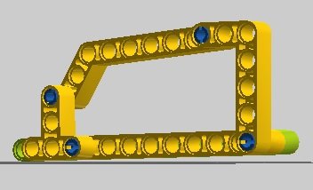

While learning LDD, I am facing a problem. I used Hinge Align Tool to fit a Bean with my model which I added successfully. But it resulted a slight tilt to my whole model with ground, which I do not want. So now one end of model is on ground where other is a bitrHow can I rotate the whole model to rest it completely on ground?
You'd just manual-hinge it using a temporary pin on the left. That said, better write down the angles of the working result, and re-hinge it manually because hinge align doesn't work really well.
Or put a pin in the lime/green part, and set the angle between the new pin and the build to 0° (or 90°, or ±180°, or −90° depending on what you want).
