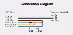

Hello, see connection diagramm,in picture below, maybe this is usefull.

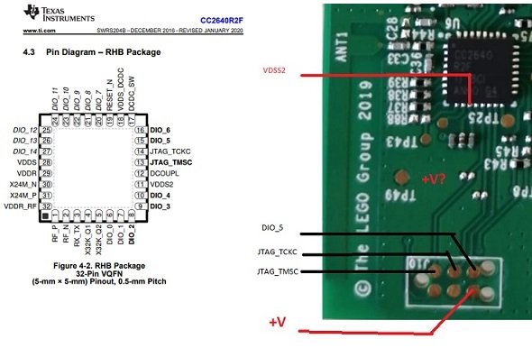

The two 3*2 contacts rows in top left, and lower right corner , seem to be the JTAG deg/flash ports of STM and TI microcontroller.
Correct, just for the sake of clarity, quite the opposite.
Top left - J10 -  is for the CC2640R2F, the TI bluetooth controller
http://www.ti.com/lit/ds/symlink/cc2640r2f.pdf
http://www.ti.com/lit/ug/swcu117h/swcu117h.pdf  (for JTAG details)
I did an attempt to understand it a bit more, see the schema. Hope it helps.
I have no idea on the STM32 JTAG connector's pinout (J8).
My 2 cents!
