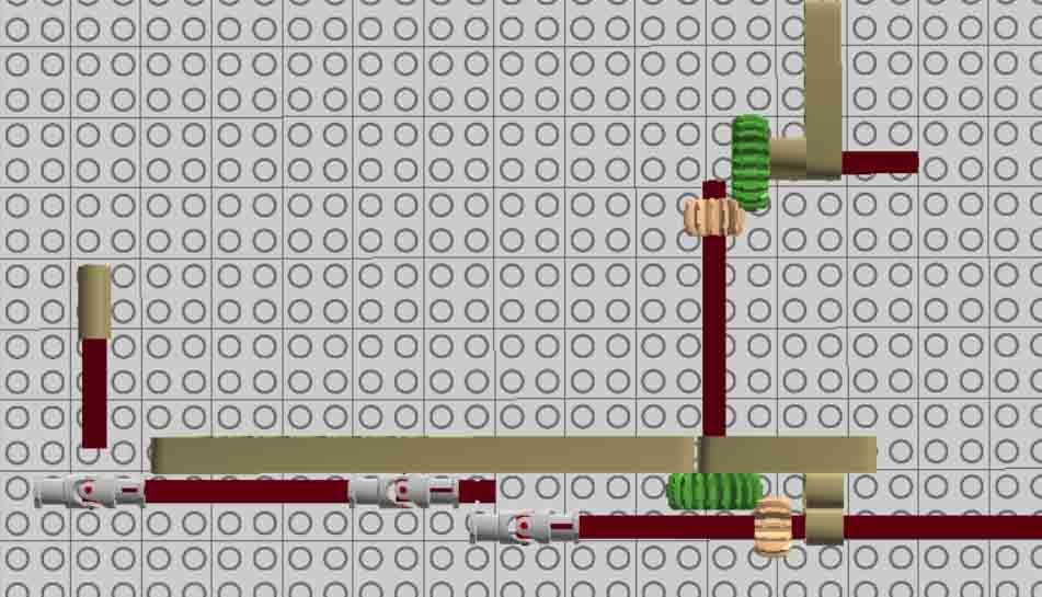

One thought of the linkage between gearbox and Spoilers. This is the very first prototype.
At first, I was thinking, if  I could achieve linkage between left side of the gear box, which is the 4 speed gearbox, the selector will turn 90 degrees every time you push the control rod. However, basically there are two difficulties. The first is there is a big gear at the back of gearbox. I am not sure if there is enough space for any other gears. The second is, the left side of car body is much compact than right side. So I ask myself if I could do the same thing at the other side.
For the right side of gearbox. It may not be able to show every movement of gearbox control rod. Since the right side will only turn 90 degrees when we push 4 times of the control rod. With the simplify modification of @Didumos69 . We can lock the gearbox at 8th speed. And between 4th and 5th speed, the right side selector will turn 90 degrees. We can use this.
The following picture just show the principle and idea. It is not the real situation!!!!!!
The green gear at right top corner connect to the right side selector. I have checked that it is on almost the same level with the control hole of spoiler. With two pair of 20:12 gears. we have 2.8 time. The selector may only turn 90 degrees while the to control the spoiler open and off. The axle need to turn about 120 degrees. The ratio is about 2.67 which is very close to what we have got now: 2.8.
The axle will pass though under shock absorber, which mean it must very close to the the car frame. With 3 universal joint we may achieve this (I don't know how to bend the universal joint in the LDD, but you can understand what I mean, right? ).
There has enough space at back right of the car body for those. So I think there won't be any problem to add all these element. Some liftarm need to be add to ensure the mount of axles. I will check this later.
