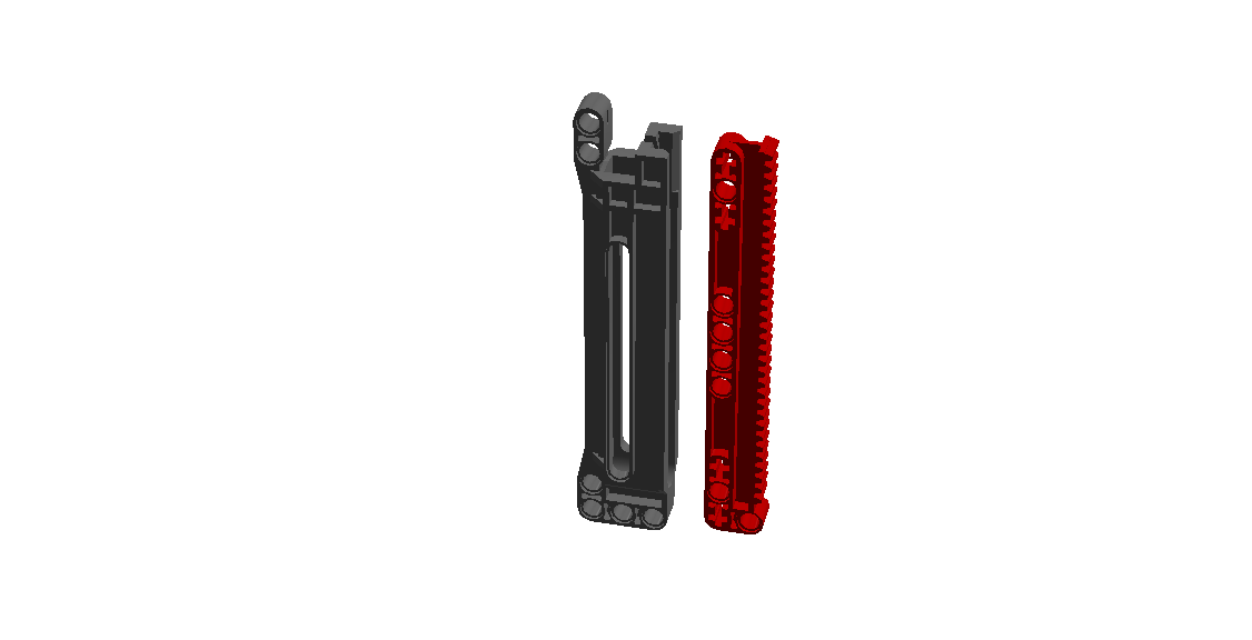

I would like to connect these 2 elements, housing 2x15x3m (#18940) and gear-rack 14x2m (#18942).
Can somebody know if is this possible or not? Thank you in advance.
Regards,
Mark
AKAIK, they don’t “connect.”  But you can put the rack into the housing with scaffolding.  (“Scaffolding” means using temporary parts that do connect.)
As you won’t be able to rotate or move them both once the scaffolding is removed, I would advise to keep the scaffolding until the last moment or to correctly place one of the parts before placing the other.

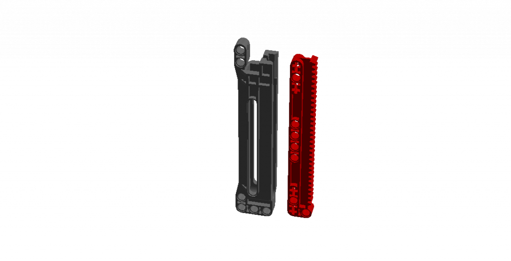

And as some help. I use this little build when I need to manually move parts into place. Here is a picture of it along with the housing and gear rack put together
