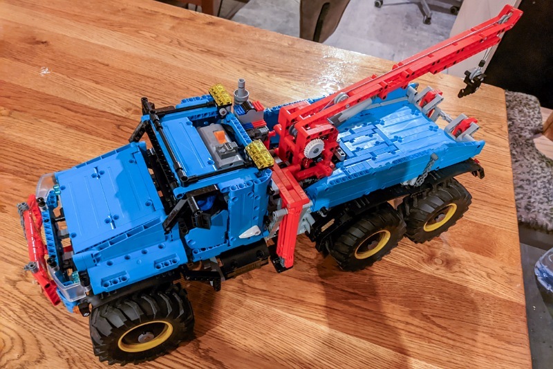

I revisited this set a few weeks ago, sorry for the huge topic kick. Initially I didn't think it was a bad set, just a bit unfinished. But I completed the bed and did a full recolor of the set. I like it now way better. It still has the silly pendulum axles in the rear and no suspension in the front though. The bed was so easy with very few parts, I'm astounded that Lego themselves didn't bother including it.
