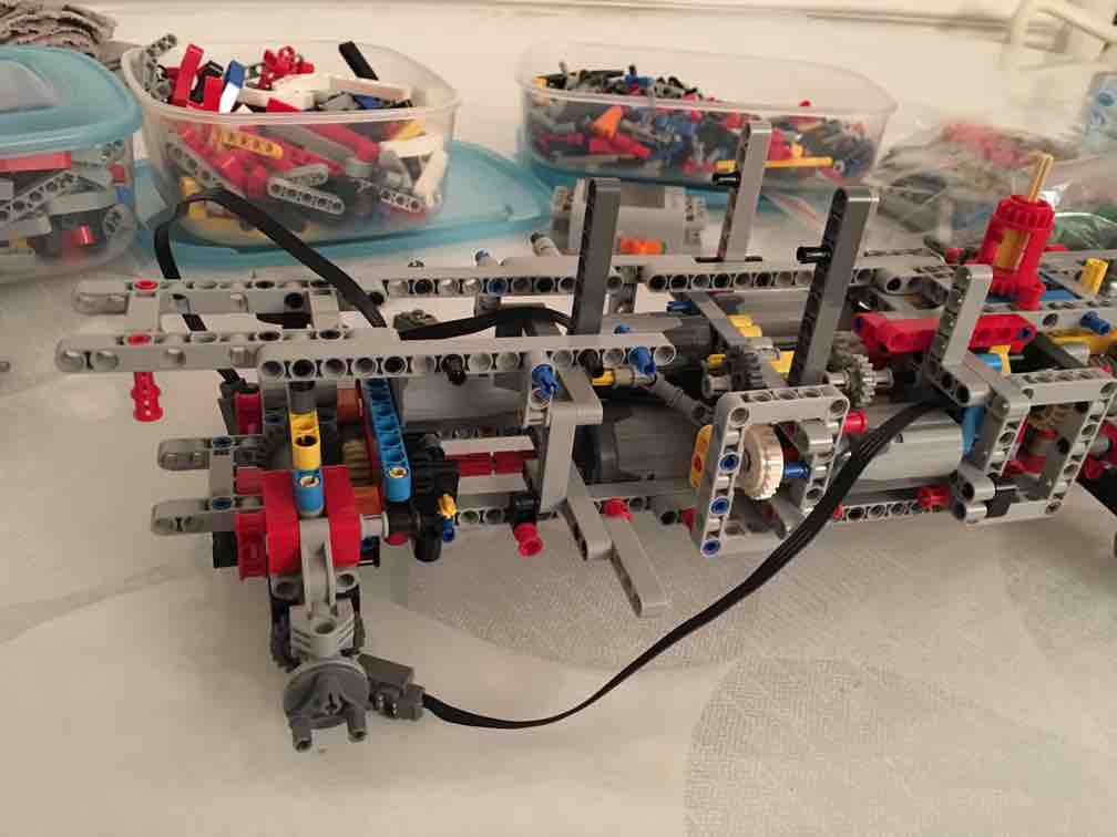

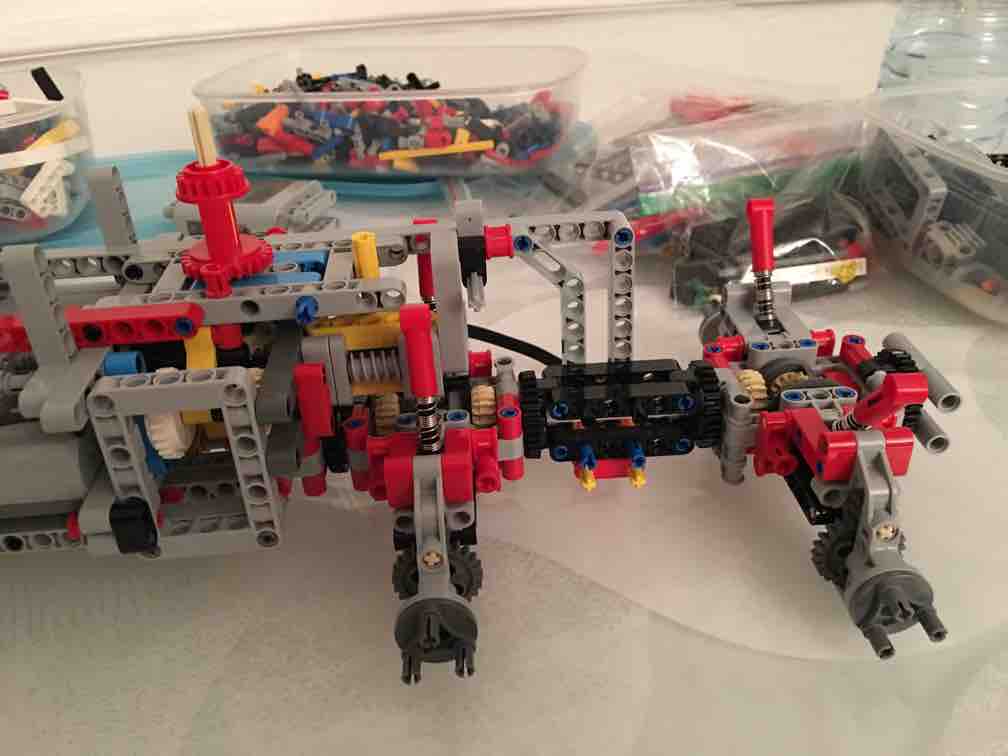

Hi, just signed up for this forum just because of this thread. Trying to rebuild the chassis from the pictures that "jim" posted on page 3. got a little stuck due to the pictures being so far from each other in the build.
Hope you finish this constuction. :)

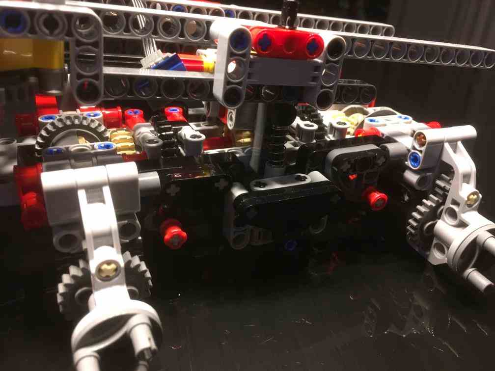

I'd like to present my mod for synchronized outriggers
I and several others have seen that the side triggers touch the ground before the rear ones, which results in some annoying creaking of the inner clutches. The gear ratios and speeds are the same for all mini LAs, so the problem lies in the geometry of the outrigger connections. So I've experimented around with different setups, with the requirement that the MOD must be as easy to be implemented as possible. The solution I found isnt ideal, as the LAs arent perfectly synced and there is still one short creak, but that's the best among what I've found.
This MOD only needs 2 9L beams that push the outriggers out, instead if the black 7L beams dictated in the instruction. The connection hole is moved 2 stud lower, and the outriggers are almost perfectly synced!
Edited by Ngoc Nguyen

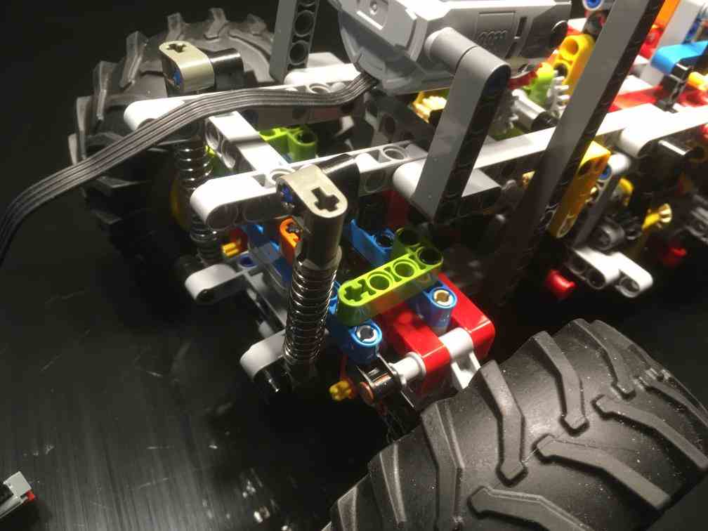

Finally I've finished my mod. All the towing functions (crane) work exactly the same as in the original model. The mod is one stud longer than the original. The extra stud was necessary to implement the new rear suspension.
uc?id=1Y30ZMwGL3InXEql3Xa4ZpgNMpe2vHodY
Here's the list of modifications:
  • Sprung load-sharing rear suspension. The entire assembly pivots in the transverse axis and each individual axle pivots in the longitudinal axis. There are two stabilizer bars which are attached to shocks to keep the truck leveled.
  • Sprung live axle front suspension using large shocks
  • Shortened chassis to provide more space for the rear axles
  • Modified steering mechanism
  • HOG steering using @efferman's design
  • Manual lock for the center diff underneath the chassis
  • No piston engine (XL engine occupies the space under the bonnet)
Pics available here. Generally I am happy with the mod. The steering could have been a bit better and the drivetrain is not ideal. It would have been better is the engine(s) (probably twin XL) were mounted between the front and rear axles. But this would require rebuilding of the whole gearbox which I didn't want to do. Here are some pics of the key parts:
