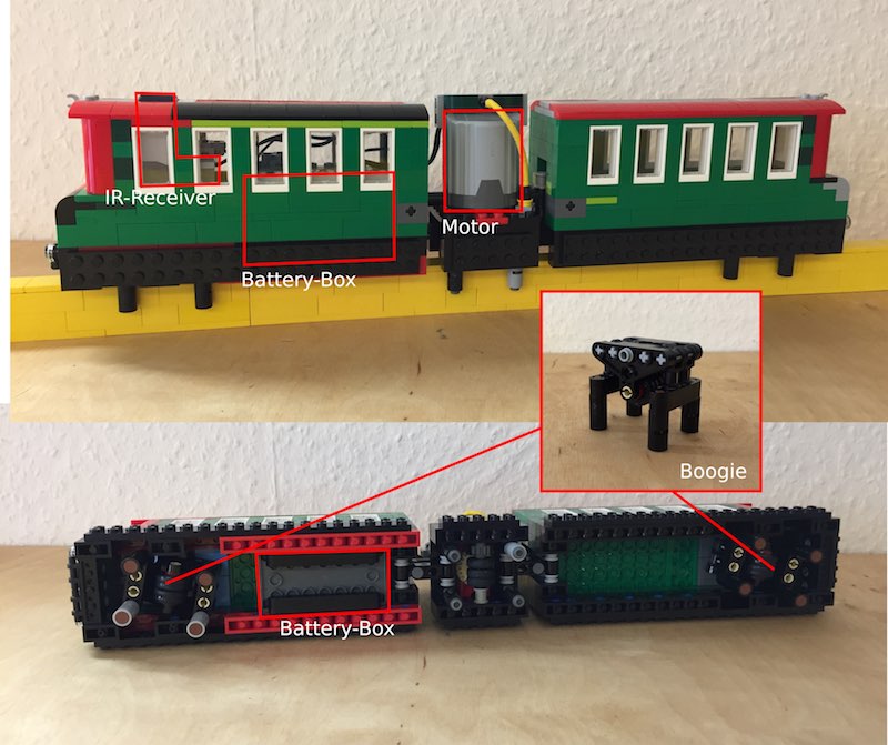

FiliusRucilo Posted February 14, 2018 Posted February 14, 2018 (edited) I've build a train according to the motor boogie design of MonorailFan99. This train runs smooth in a 52cm circle. (96 Tiles 2x2). There is no noticeable speed difference between straights and the 52cm curve. ...and YES! Parts in the "correct" color are ordered already on BrickLink. Edited February 14, 2018 by FiliusRucilo Quote
Trekkie99 Posted February 14, 2018 Author Posted February 14, 2018 (edited) On 2/14/2018 at 3:12 PM, FiliusRucilo said: I've build a train according to the motor boogie design of MonorailFan99. This train runs smooth in a 52cm circle. (96 Tiles 2x2). There is no noticeable speed difference between straights and the 52cm curve. *snip* ...and YES! Parts in the "correct" color are ordered already on BrickLink. Expand Hey @FiliusRucilo! Didn't know you were on Eurobricks! Sweet monorail! I also love your boogie wheel design. Would love to see a video of it running. BTW, you've done some splendid work on improving the Masao Hidaka monorail design! Cheers! LMF Edited February 14, 2018 by LegoMonorailFan Quote
