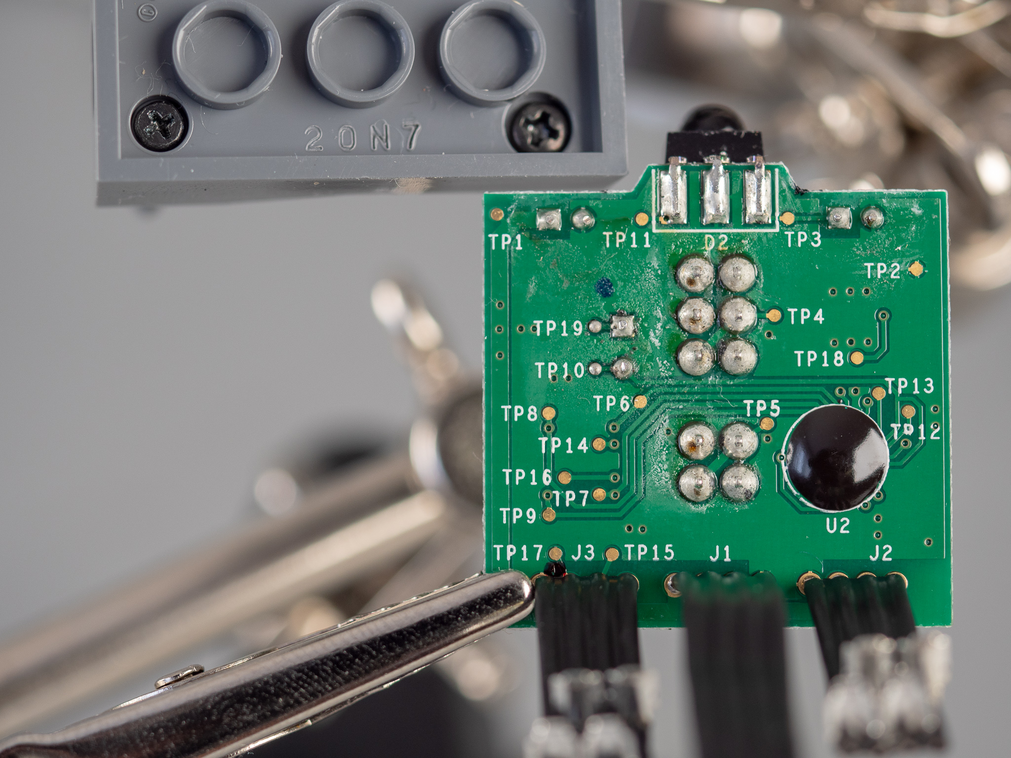

I have V1 receivers with 3 different production dates between 2015 and 2017 and I took one V2 to compare with. All V1 receivers I checked have the LB1836M driver chip. Unfortunately I don't have a V1 receiver that is "pre-V2" for sure, but if the driver chip is the main difference then I don't think these ones will perform any better. Took some photos, probably you recognize something that I don't :)
V2 "40K2" side 1 / V2 "40K2" side 2
V1 "36N5" side 1 / V1 "36N5" side 2
V1 "31N6" side 1 / V1 "31N6" side 2
V1 "20N7" side 1 / V1 "20N7" side 2

Thanks for the photos/confirmations. The PCBs of your V1 receivers are slightly different from the old pre-V2 ones (photos on my remte receiver page), but all use the same LB1836M chip so performance should be very similar.
As a side note, the number above the channel switch is most probably a date code of PCB manufacturing, well in sync with LEGO date code on the case:
36N5 PCB was done in 2015 week 22
31N6 PCB was done in 2016 week 23
20N7 PCB was done in 2017 week 10
@agrof I did a quick test with my 9398 and the V1 receivers I have here (including yours from 2017) have a worse performance than the V2 receiver. This supports the assumption that no design change/upgrade was made to them. It was a quick test on a slope, the vehicle was able to climb it with the V2 but could not do it with all the others. I'll do some more tests with different motor/receiver combinations and probably show it in my next PF tutorial video.
