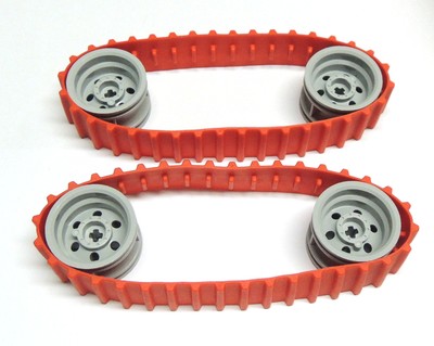

A bit late to the transmission discussion, but I would use some kind of it to protect the precious RC motor when the spinner stalls. Maybe such rubber tracks would have been useful:
$(KGrHqNHJFQFH+s2IPcNBSGqc!wbyw~~60_1.JP
or the small ones:
Right that would have been ideal in the first setup, unfortunately I don't think they would be long enough though. Anyway it's not needed now anymore but thanks for the suggestions!
