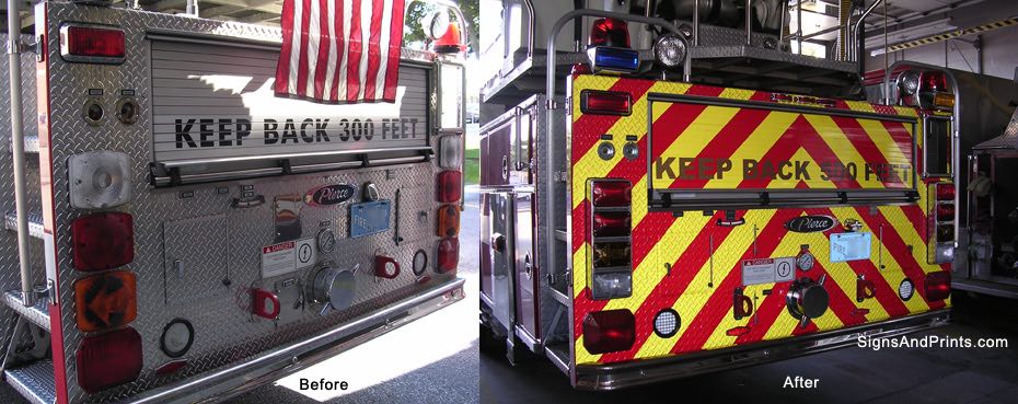

thatrabidhobo Posted December 12, 2016 Posted December 12, 2016 (edited) Another reason for outriggers on wheeled machines is that wheeled machines are designed to operate within the local laws of public road use, which means that the vehicle width and height is constrained so the outriggers allow the vehicle to have a wider width and stance for better stabilization. All this allows the wheeled machine to transport itself, unlike tracked machines, which must be transported by trailer. I am unsure if there is a universal name for the striped warning marks but in my profession they are called chevrons. We use large red and yellow chevrons so it is unmistakable for motorists that are hundreds of feet away that something large is in the roadway ahead. Below is an example (not my picture). Edited December 12, 2016 by thatrabidhobo a few word changes for clarification Quote
BusterHaus Posted December 12, 2016 Posted December 12, 2016 1 hour ago, thatrabidhobo said: I am unsure if there is a universal name for the striped warning marks but in my profession they are called chevrons. That's the universal name for this pattern. Quote
