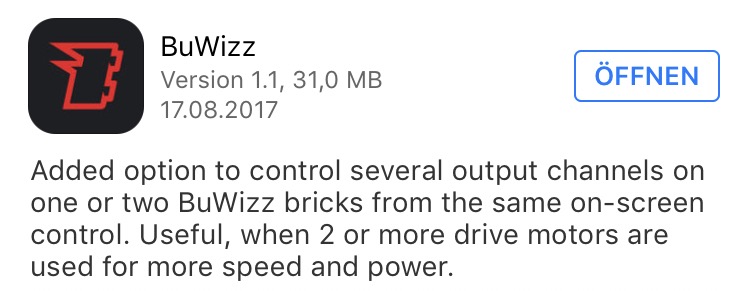

kbalage Posted August 24, 2017 Posted August 24, 2017 I noticed a strange behavior with my BuWizz units and the Android app yesterday - if I try to configure the app to control the 2 units simultaneously (Mobile crane profile), the app messes up the controls, e.g. if I configure only 1 unit with a slider or the joystick and the other unit is not yet configured, it still controls the outputs of the second unit as well. Tried this on iOS, I could not replicate the problem. Tried to reinstall the Android app but the behavior is still the same. Single unit profiles seems to work ok. If there's anyone with 2 units and an Android phone, could you please test if the mobile crane profile works for you? Not sure if the app was changed recently as my phone said it was updated 3 days ago, but the changelog in the app says the latest update was in June. Quote
jrx Posted August 24, 2017 Posted August 24, 2017 Can't give proper feedback to the "Two-BuWizz-Problem". But the app was update only days ago. They changed the code for the use of two BuWizz. Quote
Void_S Posted August 24, 2017 Posted August 24, 2017 Finally! @jrx, thank you! Now BuWizz can reveal its true power with four motors! I believe even with four buggy motors, that would be amazing... Quote
jrx Posted August 24, 2017 Posted August 24, 2017 (edited) On 8/24/2017 at 3:21 PM, Void_S said: Finally! @jrx, thank you! Now BuWizz can reveal its true power with four motors! I believe even with four buggy motors, that would be amazing... Expand There's no need to believe. For sure it's possible as I demonstrated in one of my last videos. There I power four buggy motors via SBrick simultaneously - with full BuWizz-Power. Have a look at: https://www.youtube.com/watch?v=t86I0q_A3gY Edited August 24, 2017 by jrx Quote
