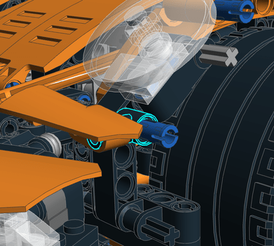

langko Posted February 13, 2021 Posted February 13, 2021 On 2/13/2021 at 7:05 AM, chlego said: Looks a bit unnatural to me but still way better than the gap Expand Unnatural in what way? To be clear they’re not attached to the bonnet, they stay exactly where the are when the bonnet is opened. Quote

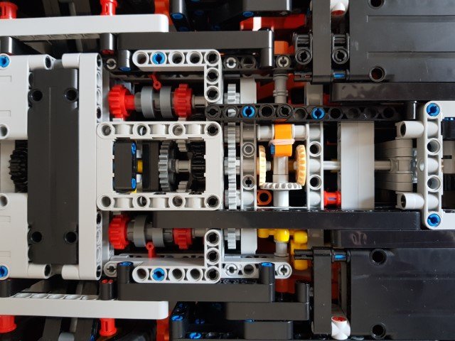

Piotr Mocko Posted April 4, 2021 Posted April 4, 2021 (edited) I have built Porsche 911 GT3 RS and applied fixes from community-driven errata by @Didumos69. But I was lacking the visibility into the gearbox. Inspired with the Lamborghini Sián set, I have decided to modify the chassis to make the gearbox visible at the bottom of the car. Moreover, the goal was to not use any additional bricks that are not included in the set. My modification to expose gearbox can be applied to the original set as well as to the variant with the community-driven errata. Download PDF instruction Edited April 4, 2021 by Piotr Mocko PDF instruction attached Quote

Slinger Posted September 26, 2021 Posted September 26, 2021 On 8/12/2016 at 9:45 PM, nerdsforprez said: This method: Pretty much the same method used by others here in this thread. I used different pieces just because I am away from my collection and have a limited amount right now. I don't think closing the gap that I did had been proposed yet. But this thread is so long; I haven't read the whole thing or followed it the whole time. I would not be surprised if someone else had proposed it. But I have not seen it. Expand Sorry for quoting a very old post... but since moc-pages is down, can you share details on how you covered up the hole under the headlamps? Or maybe someone else knows? I've been looking at attaching the smaller panels with friction pins using either 42003 or 6536. But I'm worried it will feel "unfinished" since it will not be completely fixed in place and can be rotated around two axles. Maybe there's a better solution? Or if it's the only way, would 42003 or 6536 be best? Quote
nerdsforprez Posted September 27, 2021 Posted September 27, 2021 On 9/26/2021 at 7:44 PM, Slinger said: Sorry for quoting a very old post... but since moc-pages is down, can you share details on how you covered up the hole under the headlamps? Or maybe someone else knows? I've been looking at attaching the smaller panels with friction pins using either 42003 or 6536. But I'm worried it will feel "unfinished" since it will not be completely fixed in place and can be rotated around two axles. Maybe there's a better solution? Or if it's the only way, would 42003 or 6536 be best? Expand Mocpages is not down. It is dead I have the original photos and LDD file somewhere, but it's so simple really no need to look for them. Take a look at the video if you need to: Right at the end, minute at around minute 1:41, you can see it. This part https://www.bricklink.com/v2/catalog/catalogitem.page?P=15100#T=C between both 1 x 11.5 bent liftarms and you are set... Quote
Slinger Posted September 27, 2021 Posted September 27, 2021 Many, many thanks nerdsforprez! Is this is the way it's attached? Looking at this solution, it can still be tilted a bit, but I'll settle for it since it's for display, not playing. Quote
nerdsforprez Posted September 27, 2021 Posted September 27, 2021 yes. that is it. And yes, it can be tilted, but that is what you want. it allows for better coverage. Quote

jb70 Posted June 28 Posted June 28 On 4/4/2021 at 7:55 AM, Piotr Mocko said: I have built Porsche 911 GT3 RS and applied fixes from community-driven errata by @Didumos69. But I was lacking the visibility into the gearbox. Inspired with the Lamborghini Sián set, I have decided to modify the chassis to make the gearbox visible at the bottom of the car. Moreover, the goal was to not use any additional bricks that are not included in the set. My modification to expose gearbox can be applied to the original set as well as to the variant with the community-driven errata. Expand Inspired by @Piotr Mocko I modified the bottom of the chassis to have a clear view to the complete gearbox from the underside: And I reinforced the removable body. Now it is very robust and can be grabbed with one hand under the roof. Here is the improved section of the windscreen: Looks fine in the complete build. Quote
