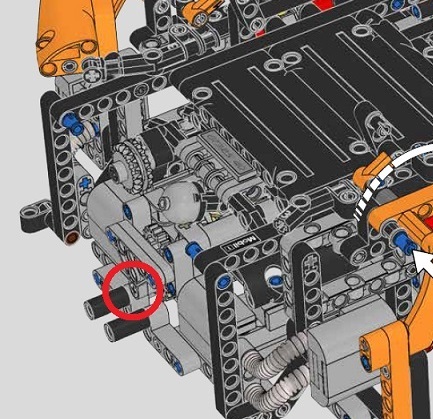

I3Brick Posted October 24, 2016 Posted October 24, 2016 (edited) I was wondering if anyone has a suggestion for the following: I want to motorise my model, but only require it to function when the wheels are off the ground. The point is to show off the gear shifting function by seeing the wheels turn slower or faster when shifting. Since having the car resting on its wheels adds too much weight (requiring big motors and potentially running into issues with the drive train/wear and tear), and since I don't want to have a fully RC model, this should be less complicated than a fully RC model. I don't mind if the motor is external to the car. The most convenient spot I found so far to do this is at the back. My plan is to extend the axle marked in red on the picture (passing through the lowest of the two grey gears used to make the engine turn) with one stud. That way I can connect an axle connector with L-motor to it when I want to show the functionality, and I can easily remove (and hide) the motor when the car is on display. That would mean I'd have to split up the long black 15 stud beam of the rear bumper from step 597 into two smaller beams, so that the axle could pass through. Not sure what the overal impact will be on the sturdiness of the rear bumper if I do that, it seems to be a rather structural element. Any suggestions for the 'connection point' of the car and the motor? I am hoping that with the car off its wheels, a single L-motor will suffice to operate the entire drive train without causing too much wear and tear to all the gears. I'm not going to be running the car like that for long periods of time, but there's still a lot of gears involved. Thoughts and tips are welcome. PS: I did see the video posted by schraubedrin on page 13 of this thread. It looks like one of the easiest ways to connect an L-motor, but it connects to the rear wheels directly, meaning that you will only see the speed differences of shifting in the engine pistons. Those are hard to see, less spectacular and you can only apply this when the chassis is removed. I'd prefer a method that works with the chassis on as well. PSS: I also know stevenhalim tried connecting an L-motor and it worked with wheels off the ground (allbeit with Didumos69's mods, which I haven't all implemented), but I've got no idea where exactly he hooked up the motor and if anybody else tried doing this. Edited October 24, 2016 by I3Brick Quote
Didumos69 Posted October 25, 2016 Posted October 25, 2016 (edited) On 10/24/2016 at 6:00 PM, I3Brick said: The 90° limiter I purposefully omitted in my list of to-implement mods, it was too much of a 'change'. I wanted to avoid mods that required medium or big changes during my first build. But it's a very elegant and effective solution based on what I've seen and read. If it turns out that for my purposes my build doesn't work well enough, it will probably be the first mod I'll add to the build. But since for now I only intend to display the model and once in a while hook up an L-motor to the fake engine to show the functioning of the gearbox (with the wheels off the ground), I hope it won't be necessary. Expand I get it. I visited Lego World last weekend and there was a Lego fan demonstrating the Porsche. He used a motor to show the shifting mechanism and after a few shifts the entire setup stalled because of double engaged gears. I hope you'll do better . Good luck and have fun building! Edited October 25, 2016 by Didumos69 Quote
