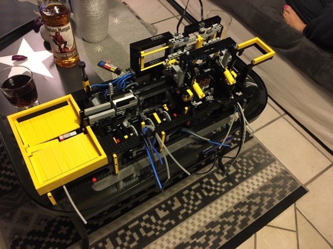

I would like to share with you some of my progress in building Ball Cleaner this will be is version controlled by NXT brick.
I would like to share more images but as it goes this forum allows me to post it only 1 image with really shit size of 100k thanks for 2018.... This project is quite complex so I putted it together based on the images and videos which are published online. Currently my biggest challenge is missing section which is located at the end of the ball cleaner right under the bridge which is leading clean balls out, specifically part of the module where is located shock absorber which is pushing pneumatic cylinder, on which are attached tiles black and white colour and this tile are scanned by NXT light sensor.  I think this device functioning as a electronic pressure sensor and I also think that this sensor switching on ball cleaner under right amount of pressure which is necessary for correct functioning of whole ball cleaner. From all the images and videos I can not build electronic pressure sensor exactly like Akiyuki therefore I can  finish whole ball cleaner into functioning device without electronic pressure sensor so if anyone knows how to do it please let me know. This version in my humble opinion is similar up to 90%or more in terms of  internal parts which are not visible on the images or videos .   So having said that if anyone find it useful and need any support please do let me know I would be happy to send over more images. Like wise please if you know any solutions for electronic pressure sensor pass it over to me?
In upcoming days i will be finishing connection of all tubes.... and then i will put in a place NXT brick after that I will be able create a program.
Please, anyone knows how to attached bigger size of images or possibly upload  videos ? Thanks

welcome, nice progress, did you have a look on bricksafe? there are some detailed photos from akiyuki on there, this is also the site we use for images

Thanks for your interest and info given about images on the Brick Safe, I already seen it and used some of them in my project.
Any more useful info please do not hasitate to contact me! Mainly info regards pneumatic electronic sensor.
I will add more pictures one of them will have highlighted part where I am stuck at the moment. (pneumatic electronic sensor)
https://bricksafe.com/pages/drullph20/lego-ball-cleaner
