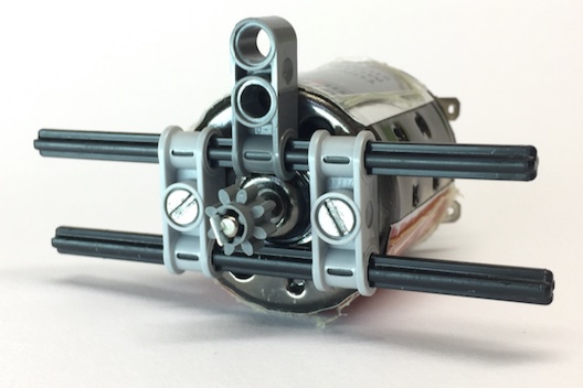

Essge Posted September 13, 2015 Posted September 13, 2015 (edited) Hello. I hope this havent been posted here before :) When 1 XL-motor is not enough, use 2, or 3, or 4 and so on. I have stopped using XL-motors. They are too slow. I use buggymotors instead or just a 540 size brushed crawler motor. Axial got 3 types of brushed motors. 20turn, 27turn and 55turn. The price is a lot lower than buying a Lego motor compared to the torque and speed. I chose to use the 27turn. The width of the mounting holes for 3mm screws fits perfectly with theese 2 cross blocks 2x1. The pinion have 12 tooth. With a 36 tooth Lego gear, I get 3:1 ratio This works great in the right truck. I dont think its very wise to use a lot of u-joints and cv-joints. Theese even break when using xl-motor. For steering. I use a 9 grams servo hooked up to a PF-switch. Like this pic below. I hope this can entertain you guys and gurls on the forum. Let there be questions :D Edited September 13, 2015 by Essge Quote

Essge Posted September 13, 2015 Author Posted September 13, 2015 Most of the brushed motors will work as long that you can fit the M1 pinion and a way to mount it to lego parts :) Quote
Brickthus Posted September 14, 2015 Posted September 14, 2015 OK, looks like 12-tooth mesh with 36-tooth LEGO cog would work reasonably well. Better have a supply of 36-tooth cogs for predicted wearout though! How well does the shape of the metal cog match the shape of a LEGO 12-tooth cog? What is the typical speed and voltage for this motor? I expect faster than LEGO motors, which is good, but is it meant to be 9V or 12V for extended running? What is the no-load speed of the 27-turn motor? Halving this value will give the optimum loaded speed, at which maximum electrical power is transferred to mechanical power. I see you have an RC motor driver and battery pack. Might be too powerful for LEGO parts. What is a typical RS540 motor current (they usually go only by turns and not electrical parameters)? Would a LEGO LiPo motor driver be OK with the load? It is limited to 800mA output. I guess that means the current limit could keep it safe for the LEGO parts, so that only the 36-tooth cog would be prone to wearout? What about motor heating? Is it too hot to touch, or too hot for the adjacent LEGO parts? I think my old car tyre air compressor uses an RS540 motor, which would have been from a car 12V supply (up to 14.4V but low duty cycle as they are supposed to stop after inflating one tyre). It might be worth trying to liberate the motor to drive jet engine models! I did try harnessing a dremel-like drill but 135W was too much for LEGO models and at 10,000rpm it melted the axle! Hence the best alternative I have so far is 4x 47154 Technic motor at 4000rpm no-load (2000rpm loaded) using 1.3 Amps at 9.15V. I also have a new compressor with a fridge motor for plenty of pneumatic power! Mark Quote
Essge Posted September 15, 2015 Author Posted September 15, 2015 The shape of the cogs are almost the same. The motor max input voltage is 8-cell NiMh 9.6 volts. I run 2s Lipo 7.4 volts. No-load current do I not know, but the esc can deliver up to 106A. Try google "rs540 current" (etc). The you will find your answers :) The motor can get hot, but a lego truck is not hard to make go forward. I dont think the overpriced Lego Lipo can handle any 540 motor Lego Lipo costs about $50. It is a 2s 1100mah. A standard 2s 1300mah Lipo from a norwegian site called elefun.no costs about $15. Then you only need to make a cable to the PF-IR. Quote

New_User Posted December 29, 2021 Posted December 29, 2021 RS380 motor and those bigger ones are not lightweight and these motors are only threaded at the front end, not the back. Maybe we should also look into how to support the back end of the motor itself instead of letting the weight of the motor stressing the frontal mount. Quote
jurian2007tje Posted September 25 Posted September 25 what pinion gear do i need for a 3mm shaft? (how many tooth?) Quote
Ryokeen Posted September 26 Posted September 26 18 hours ago, jurian2007tje said: what pinion gear do i need for a 3mm shaft? (how many tooth?) The number of teeths is independant of the shaft size. What matter is the tooth "spacing". Lego uses a module 1, so a pinion with module 1 with 12 teeths will be the same size as a lego 12t gear and mesh just fine. You can get 12t(or more) module 1 gears both for 3mm shaft or 5mm. So as with lego gears it all depends on what gear ratio you want. From my experience 12t were easiest to fit as you can mesh them with a 20t and have 1 stud space between to have place for motor mounting support. Quote
