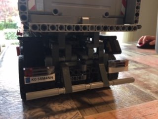

Mechbuilds Posted February 13, 2019 Posted February 13, 2019 Here's a steering solution courtesy of my brother. Quote

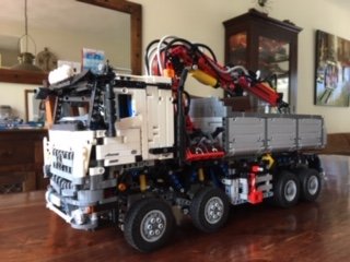

Arjan de Jong Posted May 4, 2019 Posted May 4, 2019 Hello, i'am new here. I have made some modifications om my mercedes arocs. I lowered the crane, i changed the front wheels. I made the driving and steering rc- controlled en changed the rear and front of the truck. Hope you like the picrures. Quote
